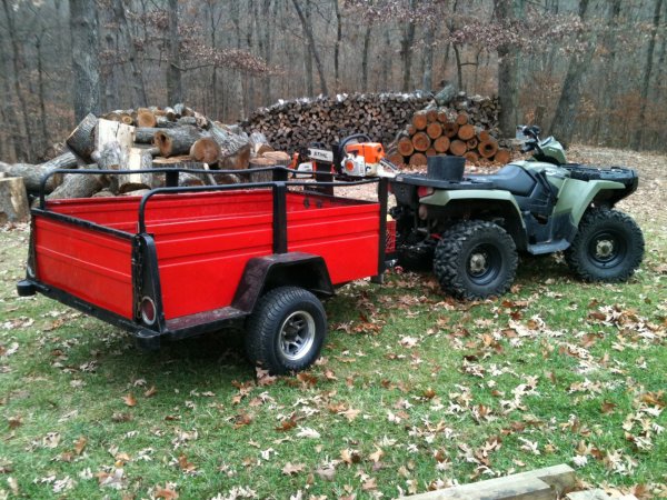

    Here's my 4'x5' dump trailer I built. I have beat this thing perty good. No springs but the axle and wheels are road rated so plenty rugged. It's rigged for hydraulics (not installed yet :whistle:) and the rear gate opens like a dump truck's (hinged at the top) I started building it in 2002 and I'll prolly get to the hydraulics soon... don't wanna hurry these things... :emb::D
    Today, I'd probably buy one rather than weld one. Used to be more fun than it is today.

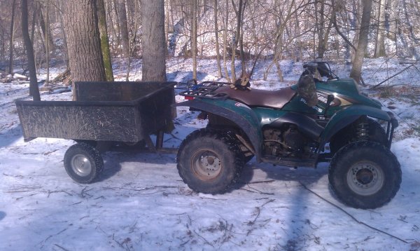

    I use the 200$ cart from tsc. After 3 years of abuse, I sent it to a welder for $50. It's now 10x stronger than a new one.
    The dump works fine as long as you can lift it...keep that in mind when loading, and it's gtg.
    I've had loads so heavy in it that the 4x4 atv couldn't get it up the hill so I had to offload some wood.

    For repairs? Or just some mods?

    A little of both. The gate was loose from some broken welds. Reason they broke is because it only had about half of the welds needed to make it right from the get go. No steel was added, just welded up places that tsc didnt.

    Winner! That's an awesome cart you built! I want one!!!!!!!!!!!!!!!!!!!!!!!1

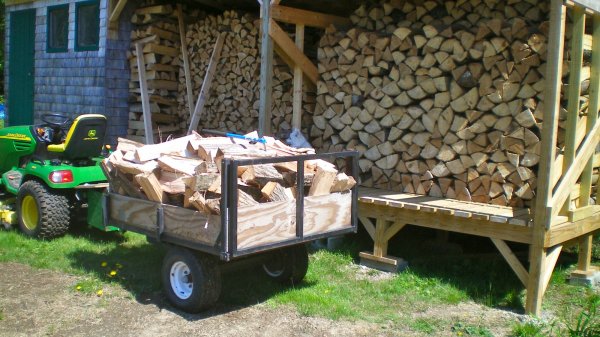

    I made some rails for mine, but they get in the way of loading and unloading, so I don't use 'em much.
    Probably just as well, or I'd probably overload the mule.:rofl: :lol:

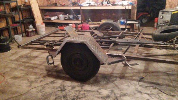

    I've been building my own trailer, taking notes from other trailers, building what I want for my needs. Today I got my fenders figured out, one is welded the other side is ready to fit and weld, 3/16 tread plate and solid 3/16 plate on the inside 1.5 angle on the outside, tread plate for step ups I front and in back of the fenders, tomorrow I will be finishing the fenders, starting and hopefully finishing removable siderails, if I get that done I'll be putting on my 2x10 bed on that, the trailer is 5x10 3500 lb axles, it'll be a wood hauling machine when I'm done! Also have the hideaway ramps complete. So ready to have this project complete!

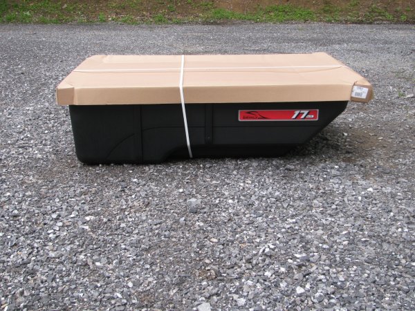

    :yes: Nice work Shag. Is this a road legal trailer or yard cart or both?
    Keep us posted and more pics please.
    I think I still want to build a cart for myself, the Brinly is for my folks.
    My little ten cu ft craftsmen here at home got a flat over the weekend. All and all it works good but I want something a little bigger and heavier and better suited for the atv
