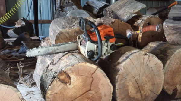

    I've got a 017/MS170 Frankensaw, It's a 017 chassis with a MS170 jug, has an aftermarket fully adjustable carb and muffler modded. I'm running 3/8 picco in .043 Stihl 61PMM3 chain on a 14" bar. The little thing just rips through wood. I wouldn't get to carried away with the chain, I think it could get to aggressive for the little saw that it is. I love the exhaust not the mad little bumblebee has, like a wanna be big saw.
    rookie1 likes this.
  17. FarmHand78
    FarmHand78
    Jan 10, 2015
    720
    2,895
    South East Iowa
    Drvn4wood, 94BULLITT and prell 73 like this.
