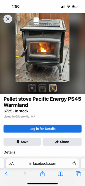

    IMG_3533.png Here she be any thoughts?

    I just looked and I don't see pellet stoves on Pacific Energy site, do they still do pellet? But, I did see don2222 has a section of replacement parts for that stove model. Any thoughts Don?

    Nice stove, But no longer made and some parts might be tougher to get. The guy I helped install his is selling his due to parts being expensive. It was a one off project from Pacific Energy and shares no sister models. A bit of an exotic stove IMHO. He wound up buying a Quad CB1200.
    I'd be sure parts like the control board are still available. Also the agitator, burnpot and any other unique parts. Or you will be stuck. Same goes for any other stove I guess!

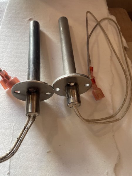

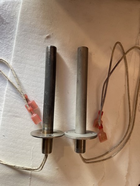

    I do sell all the parts for the Warmland and just the other day a customer needed a 409 watt igniter for an older one. The new ones take a 5-3/4” and his took a 4-3/4” inch otherwise they were the same with the disc with 2 mounting holes welded to the back of it. I found that the Enviro igniter is 400 watt and the 4-3/4” long and the same mounting disc but I had to change the ends from male to female quick disconnects to plug into his stove.
    Other than that ALL the OEM parts are still available and I have them. :)
    Pics are the Enviro igniter on the right and the old igniter on the left :)
