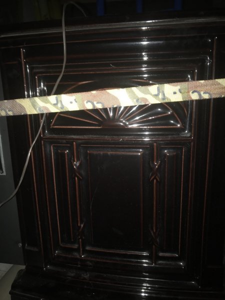

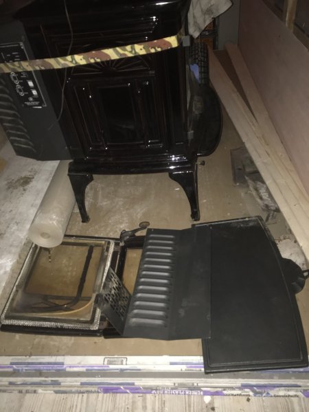

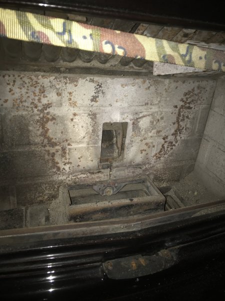

    So this is what the back of my truck looks like. Went to see the stove today. In great shape. Minor rust on interior but nothing I haven’t seen before on a stove that wasn’t sealed off from humidity. Needs a good cleaning and probably a new control decal cover thingy. Looking forward to breaking this one down. Didn’t get to fire it up so hoping all motors are good. This one will be flipped but I do love the enamel finish

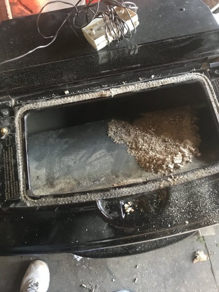

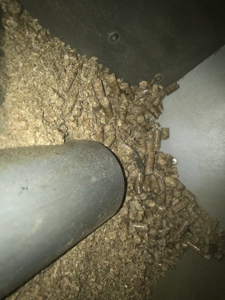

    A couple more pics. I’ll get it out of the truck today but won’t get to work on it till Monday. Wife just informed me we are spending the day together shopping. How exciting. I wonder if she means Pellets.

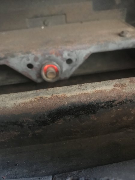

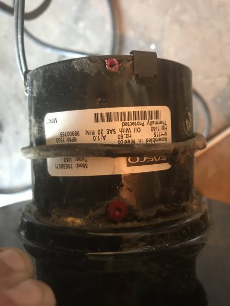

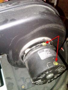

    Are the red things removable plugs or do I just add oil directly. Tried to remove one as you can see but just falling apart

    ConvectBlowerOilHoles.jpg Get needle nose pliers for the bad one. Plugs come out, then 3-4 drops of 3 in 1 blue can, or anderol.

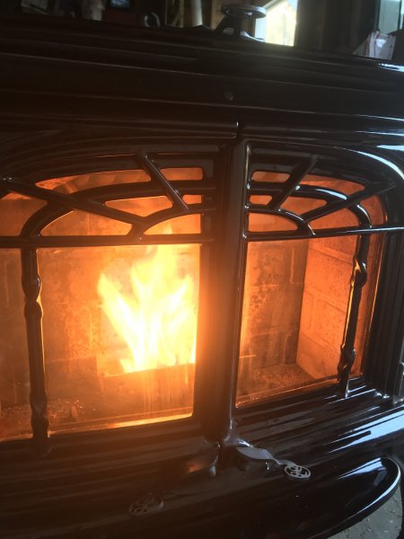

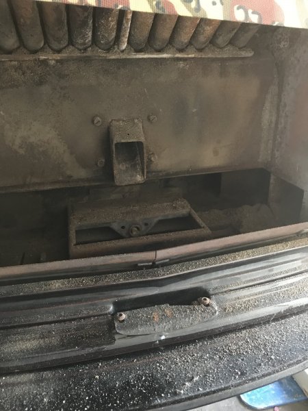

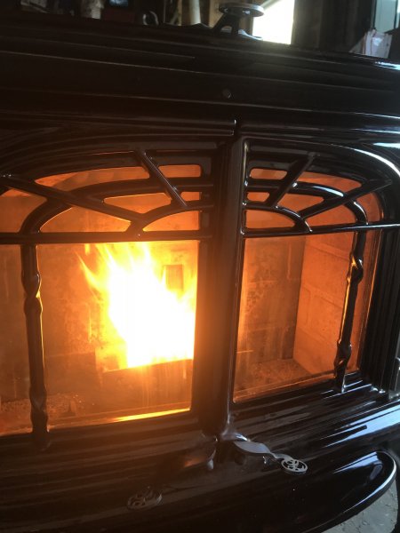

    So I took the back off and tested everything in the stove using a test cord. Everything working good and quiet. It’s all original parts by the looks of it. I did take the convection blower out just so I could get a few drops of oil in there. Blasted the rest of the stove with compressed air and put rear of stove back. Cleaned the combustion chamber while I had that apart too. I removed all the innards of the stove and it that with compressed air too and ran a bottle brush thru all the passages to make sure there were no blockages. Put it all back together and she wouldn’t fire. Retraced my steps and remembered I didn’t check the vac switch. Disconnect tube from switch and tested it with a little sucksge and could hear it click. Blew into hose and could tell right away it was blocked. I opened up the combustion chamber and reached in to where the port was. There’s a tiny little shelf that sits right below the port that was caked with hard ash. Was able to free it up and reattach hose and voila. We have fire. Super impressed with this stove. It’s been running on high now for about an hour and kicking great heat even with newps.

    We need pics of fire, or it really didn't happen. :D
