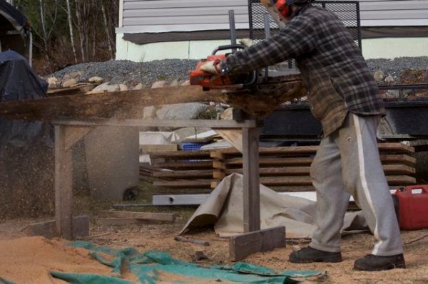

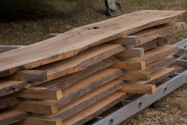

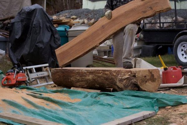

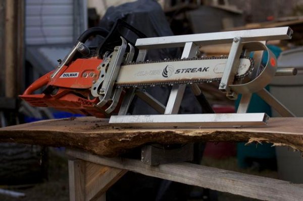

    Hello to all...I'm a new member here.....I owned a Dolmar 7900 till recently witha 24" bar and Alaskan Saw Mill. I can say that this saw is a brute and a very good quality....I've attached some pics of a 20" Red Oak being sawed into live-edge planks. I can say that the saw went through the wood very easily with plenty of power to spare. I cannot attest to anything over that size however nor too the oiling capacity of a longer bar.....but I am confident that this is a very capable saw.....:salute:.....Twister

    I like that setup in your photos that shows you milling "downhill" at a comfortable height. Helps a lot.

    Yes it's always a good idea to get gravity to lend a helping hand when it can.....anything to take the pressure off the ole' bones! :BrianK:....thanks for the post....Twister
