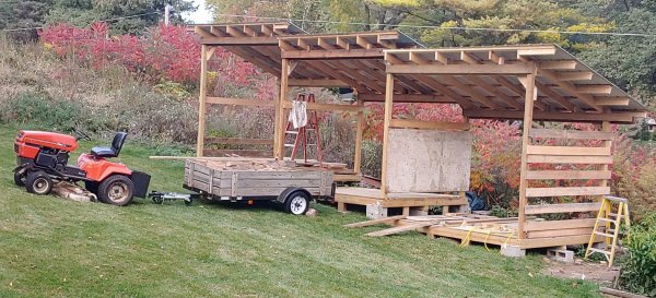

    We'll need to straighten the right bay's purlins a little at the front next spring. Not something I'm going to deal with this fall or winter though.
    I don't know who was measuring, but it was off on the right side.:whistle:

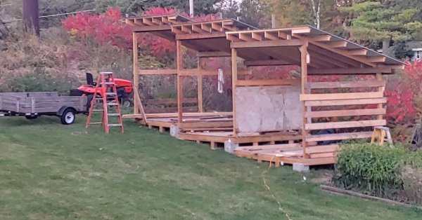

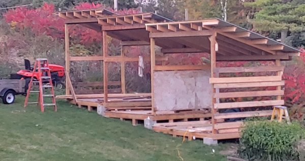

    More work today on it. I added diagonal bracing at the top corners. I have a couple more to do but all the ones in the back are finished. You just can't see most of that work;).
    I put up the right side outside wall, but I think I'll cut the spacing between the boards from 5.5" down to 3.5". That will put a gap between the 1x6 and the 2x6 side brace.
    I put up the 4x8 plywood as a wall I figured I had it, and might as well use it.
    Tomorrow I can make the other inside wall, do more bracing, start filling the shed, moving wood up to the patio, and build a ramp to get the tractor under the roof in the right bay.

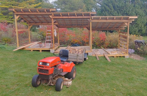

    Ok. Motivation happened.
    I got more upper corner bracing done.
    That's a face cord of mostly sugar maple, with a little ash in there too.
    I don't like to put more than a face cord in the trailer to haul on the lawn. Those narrow trailer tires will dig in to my lawn. This was uncovered since I split it this past winter so I wanted to get it under cover.
    It's going to rain tomorrow so I wanted to get some wood into the shed and get the tractor under a roof. I've got another half load of the sugar maple left to get under cover. Maybe I'll get that done tomorrow evening if it isn't raining then.
    I also didn't want to put too much in the shed as I don't have a back wall brace on yet. :whistle:
    I don't know if I'm going to put more than the 2x6 mid beam on the back of each bay anyways. The wood when stacked like it is, can't go anywhere, especially with a 2x6 up 4 feet from the floor.
    What's nice is that trailer is the same level as the floor of the shed, so I can walk right off the deck into the trailer bed and back really easily. Didn't plan on that, but that's a nice feature. 20201011_171817(1).jpg

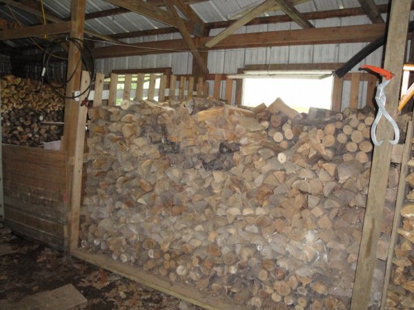

    I would worry that 1 x boards wouldn't take the pressure of the stack across an 8' span if the stack really shifted so that it was trying to "blow it out" the side...unless you plan to crib against the walls.
    My racks are 4' wide and 5.5' tall, the uprights are PT 2x4's and they bulge out pretty good when the rack has been loaded up for a few months or more, even with the top tied together with plumbers tape...hasn't broke yet, but I bet one will sooner or later.
    See if I can find a pic...ok, here...they were still brand new in this pic.
