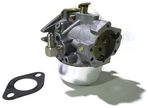

    Yeah it's a simple carb, but due to it being on top of the block on the opposed twin engine, it's a pita to R&R.

  13. brenndatomu
    20,555
    128,079
    Really? I have worked on a few of those type of engines (not that one though) and the carb was super easy to get to.
