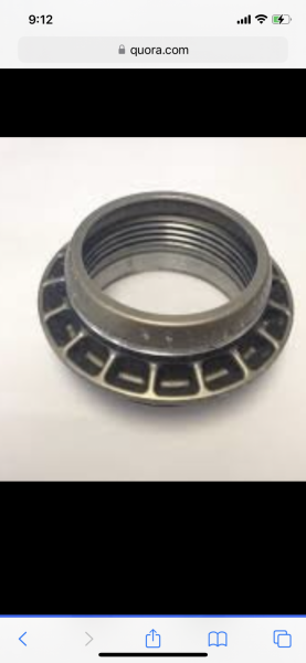

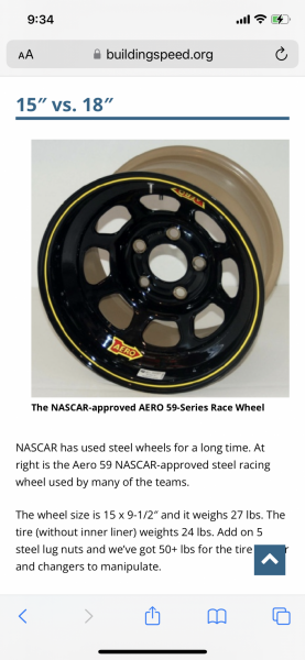

    NASCAR just announced the cars will have aluminum wheels instead of the steel wheels.
    Therefore they know having the old 5 bolt steel lug nuts would be a REAL problem holding the wheels on securely!
    Therefore they invented a large single bolt system specially designed to hold Aluminum wheels on securely due to the increased expansion & contraction properties of aluminum!
    Now why didn’t any of the automakers think of this????
    See
    NASCAR moving to single lug-nut design for Next Gen car
    vid 1
    Vid 2
    Reason for new NASCAR wheels
    NASCAR NextGen Wheels: The Scientific Argument for a Single Lug : Building Speed
