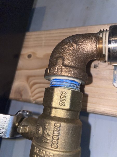

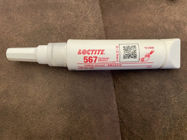

    What are the best types of sealant do people use for installing a shop air system on Brass Pipe fittings?

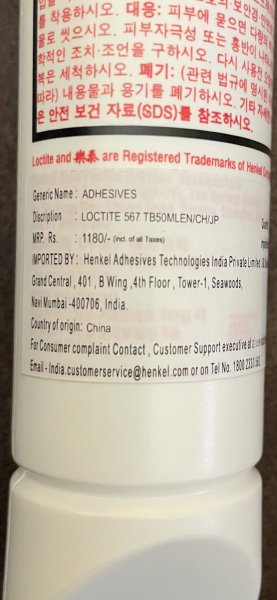

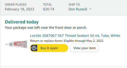

    My installer used Loctite 567 which is very hard to get! I ordered a tube of 50 ML on Mon Feb 28,2022 at it came today Sat Apr 2,2022! What happened to 2 day delivery?
    Looks like the country of origin is China??
    The tracking details in the Amazon order only shows the last 2 days when it first arrived in one of the Amazon distribution warehouses!
    The support email is [email protected] ?

    Looks like he was using a little Blue Monster tape too.
    As long as your fittings are good quality, you shouldn't need anything exotic. For tapered thread fittings and just good ole shop air - any PTFE pipe dope applied sparingly with 2 layers of PTFE tape on top works great.
    But why the tape you ask - I like to tape OVER dope because it traps the dope in the thread. When the fittings tighten and the gap between the threads closes, it encourages the dope to move around a bit more and you get less dope all over you when assembling the fittings.

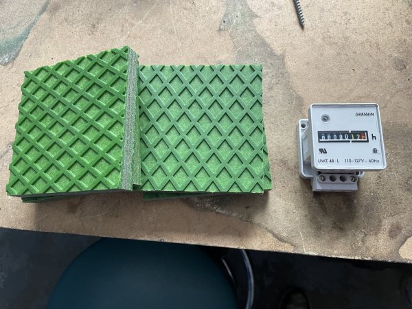

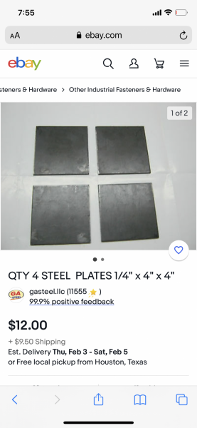

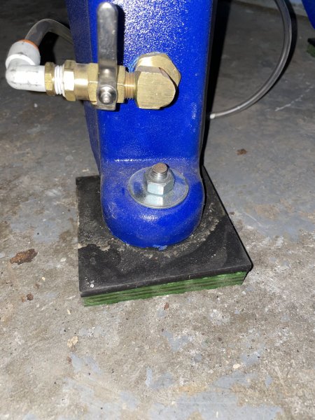

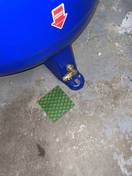

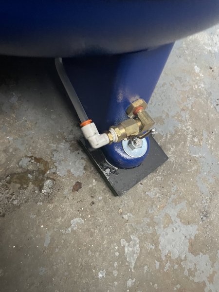

    Good Idea, but since the compressor is 720 lbs I got the heavy duty OEM pads from Quincy but the installer said this unit is soo heavy the feet will still sink in. Therefore I ordered 4”x4” heavyGuage 1/4” steel plates. I primed and painted them to avoid rusting. We used the drill press to get bolt holes in the exact center and then using the special anchor set, bolted the leges thru the plates and thru the pads. So far so good. :)

    I agree However, As part of the Quincy installation they bolt the compressor to the concrete floor so it does not move and break the pipe connections. They do not simply use bolts into the floor. They use special threaded rod anchors and nuts that are not tight so the pads have some flex to absorb the vibration. They have been building and installing them since 1919 so I trust their expertise. :)
    On smaller compressors, it is also ok to leave the compressor bolted to the pallet but the pellet would not fit in my installation area.

    My take on this is that bolting the compressor directly to the concrete is not good, but using pads even these heavy duty pads is better but do to the weight, 720 lbs of this compressor that eventually the weight of small feet will sink into these heavy duty pads! This is what the installer had seen in his experience. That is why I added 10 gauge 4” x 4” steel plates to the the top of the vibration pads so the feet will NOT sink!
    The bolts are not tight and this is what the compressor manufacturer recommends for their warranty.

    Putting plates on top of the pads is a good thing especially if the feet are cupped. Little compressors like that are pretty accommodating to mounting issues.
