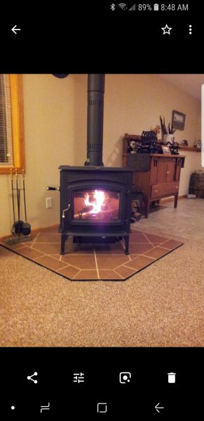

    Here is a pic of our main wood burner. Thought I would would shair!

    Nice setup. Do you have pitch on that short horizontal? Hard to tell with photo angle.

    No it just 90's out of the house I really have to keep that area clean. Thanks

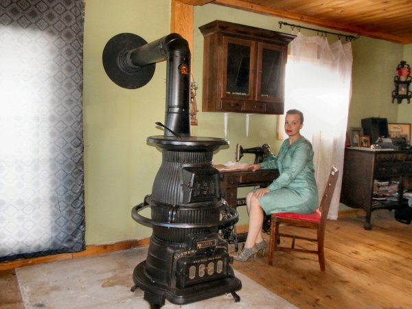

    I like nursing old stoves along, or making new cheap stoves burn better. Here in Maine woodstoves can be had for nothing (literally) so as people replace them, rebuilding them just makes sense.
    I like to have a angle grinder with cut-off wheels to help with rusted bolts. Replacing stove bolts with new ones is pretty cheap, and the frustration factor of cutting them off is sometimes easier then messing with rusted bolts.
    I like to have a variety of rope gasket sizes and shapes (flat/round/ect) because everything that can be sealed should even if original parts were not sealed.
    I prefer rope over gasket goop as the goop eventually hardens up and flakes off, typically in mid-winter when a person needs it most and does not want to redo it again.
    Welding cast iron is actually pretty easy. If I can do it, anyone can because my welder is a buzz-box AC junk unit, The truth is, using 6011 welding rod pulls enough cast iron into the weld to make it hold. The key is plenty of pre-heat, and then plenty of post-heat, so the weld cools down slowly and does not crack.
    I live in a town with a woodstove museum and old stove shop. My Grandfather worked there and so I know first hand parts are available for almost any stove. I found (2) legs for my 1893 pot bellied stove for a total cost of $30. The stove itself was free. A little welding, and the stove was ready for a fire in 24 hours.
    I can probably think of more later, but in another lifetime, I might have had a woodstove rebuilding business. because one already exits in my town now, it makes no sense to compete against each other, and our families are friends anyway. Someday I would love to have a Firewood Hoarders Club Get-together with a tour of the woodstove museum being a place to visit.
    My wife beside our 1893 Wood and Bishop Pot Bellied Stove

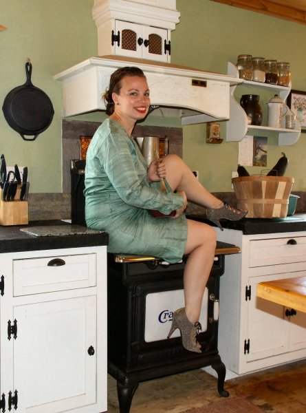

    This is our 1917 Crawford propane kitchen stove, and while it is not a wood-burner I know, fits well with our 1930's style home, and is used daily to cook on. We just lacked the clearances for a wood burner in our kitchen unfortunately. After using it for a year or so now, we would never go back to a modern stove for top cooking (too high in height, burners too small, lack of flame control, etc.) We have a modern wall oven though for oven-cooking...
