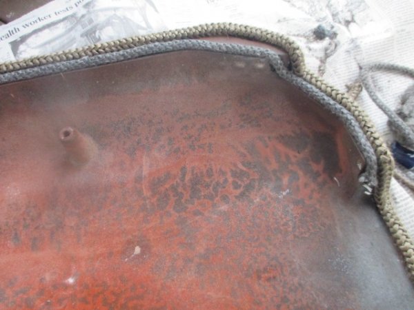

    I first started with the smoke outlet gasket. The nice feature of this outlet allows you to top vent or spin the outlet 180 degrees to a rear vent position.

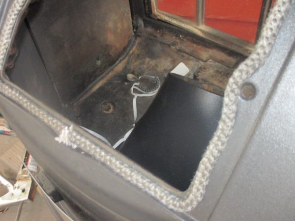

    I replaced the door and glass gaskets next. Two clips hold the glass in place. The old gaskets were falling out. The glass gasket looked like it did not have cement to hold it in place. I'm not sure if it is needed, but I put a small bead around in the groove.

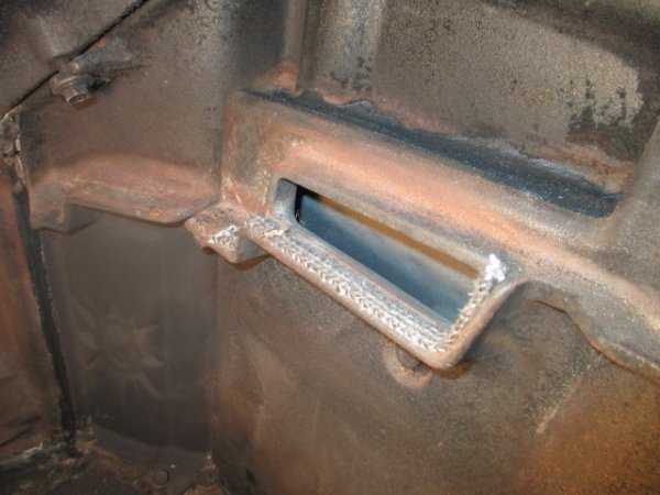

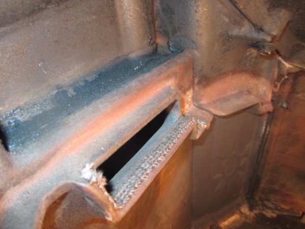

    I took the secondary assembly apart. There are two gaskets to the assembly. One is to seal the secondary air chamber where the holes allow the air into the top of the fire box. The second gasket is around the outer edge of the cast iron plate that the air chamber is bolted to. This view is the underside of the cast iron plate where the secondary air chamber is bolted to.

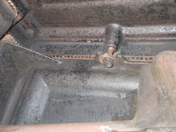

    This view is of the top of the right burn plate where the secondary air is brought in to the secondary assembly. There is a flat gasket that the assembly sits on that can fall out where removing the assembly for chimney cleaning. The replacement gaskets have adhesive to hold them in place.
    The left top of the inner burn plate.
    I replaced the top plate gasket. The top plate is held down by a bolt on each side of the top of the outer side plate.

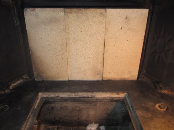

    I put the three fire bricks back in. The rear burn plate, was repainted and put back in.
    The rear burn plate is held in place by notches in the side inner plates. It is just held in place by gravity. It is easily removed.

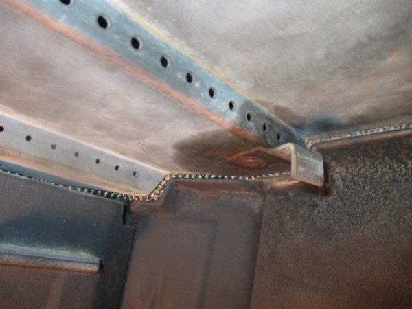

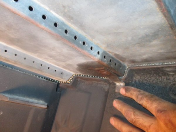

    Here the picture of the secondary assembly with the baffle on top. This has to go back in the stove and tilted to get in place and sit up on top of the side plate. The thicker gasket is what seals the assembly to the burn plates.
    Here is a nice view of the secondary assembly sitting in place. The assembly is pretty difficult to lift and get in place. It is a tight fit and awkward to handle. I'm sure a few tries, and I could figure out the correct tilt and angle to get it in and out.
    There is a tab on the underside of the secondary assembly that swings and pulls the assembly snug to the plates.

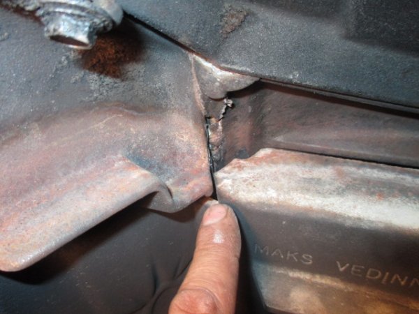

    Welcome to FHC Jimmy. Where the corners met up on the back, front and side plates, mine were good. I did reseal the secondary combustion chambers on the side. The cement had lost its' seal and crumbled a bit. The stove ran much better after that. Here is the link to that thread:
    Jotul Castine inner side plate re-sealing.
    New door and glass gaskets are easy to replace and also the glass clip gaskets.
    Well Seasoned and myself had the gaskets at the top of the inner side plates fall out of place. Those can be inspected by removing the baffle assembly. Those gaskets are flat and small and can fall down into the side plates. They should be glued down with stove gasket adhesive. Removing the top of the stove is a better way to inspect and lift the secondary baffle assembly out.

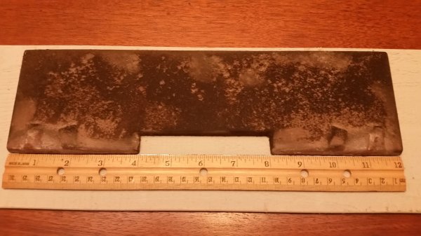

    From your pictures and the clean even heated look of it, I'm guessing it leans forward with perhaps 1/2 in clearance under lid.
    Would anyone with a tape and the time be prepared to give me a dimension and possibly an end on sketch or photo as I will shortly be making something to replace it with. My only alternative for any accuracy is a 200 mile round trip to Bristol to a showroom where they are not going to like me lifting a lid to see for myself.

    Welcome to FHC Heatmonger. I'll pull the baffle tonight or this weekend and take measurements and pictures for you. The baffle plate sits angled in the lugs.

    Hi there. That would be great.. I'm particularly interested in whether it touches underside of top, or has clearance, so a good idea of it's overall dimensions would be a great help.

    That must be frustrating having those type of costs. Baffle plate around here looks like $21.00 USD.

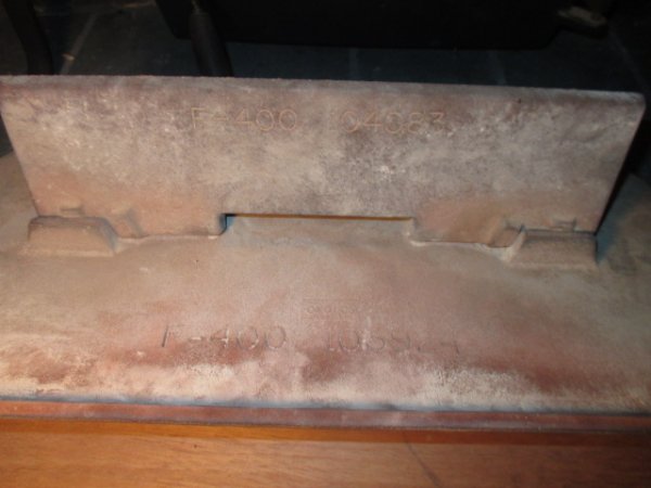

    Here is the pictures with dimensions, imperial though.
    Width 12"
    Height 3 1/2"
    Notch is 4" wide by 5/8" high.
    Cast iron is 3/8" thick.
    The baffle has lugs that fit the ones on the top of the secondary assembly.
    Baffle is pitched back maybe 5 degrees.
    I still have it apart if you have any other questions, but it is going back together tonight.
