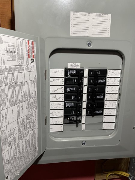

    I took the front of the Circuit Panel off and I could feel the main breakers and they were HOT!
    The main breaker plastic started melting. The wires from the meter socket were NOT warm.
    Then other breakers started to trip, like the kitchen refrig and room light, then basement light!
    What could be the cause?
    Tonight I removed the old 100 Amp main and replaced it with a new one. $47 bucks @ Home Depot
    https://www.homedepot.com/s/homeline 100 amp?searchtype=text&NCNI-5
    See pics of old and new below!
    Click on pic to enlarge
    CBpanel1-Original100Panel.jpg CBpanel2-Original100Breaker.jpg CBpanel3-NewHD100Breaker.jpg CBpanel4-New100BreakerAllfixed.jpg

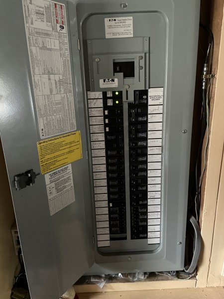

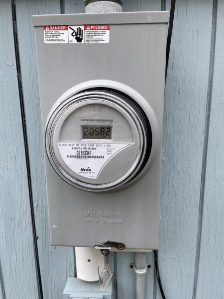

    Absolutely that is what 30 years of adding electrical goodies to a house can do!
    Therefore I did a little upgrading.

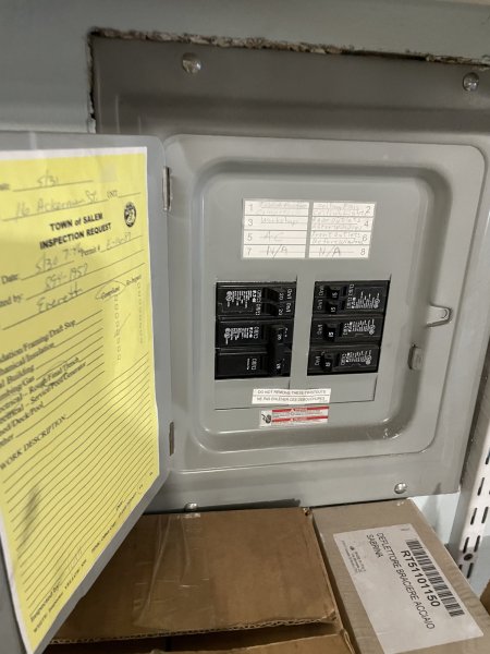

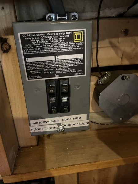

    1. New 200 amp main panel
    2. New 125 amp sub panel in electrical room
    3. New 30 amp panel in workshop
    4. New 30 amp sub panel in shed
    5. New incoming power digital meter & socket

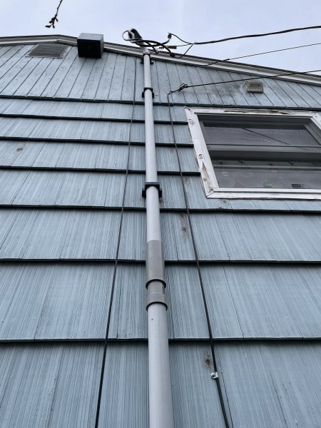

    6 New weatherhead and wiring up the side of the house and a grounding rod. Not using the incoming water pipe from the street for a ground anymore. LOL
    7. New 300 amp triplex wires from the street to an upgraded telephone pole which is 5 feet higher to meet tractor trailer requirements.
    8. Installed 2 amp meters for monitoring loading.

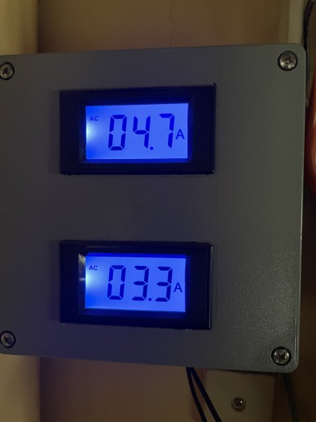

    How is that? Anything else I should do?
    All inspected by the town electrical inspector. :)
