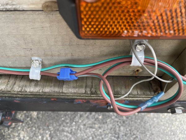

    Time to fix the weakest link! It is not if that splice connector will fail, it is when it will fail!!

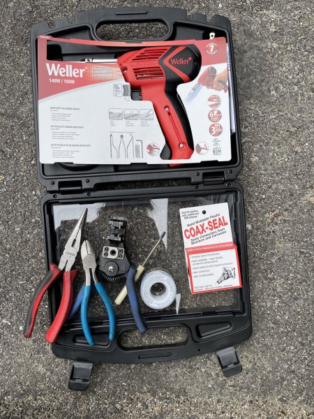

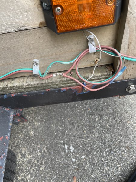

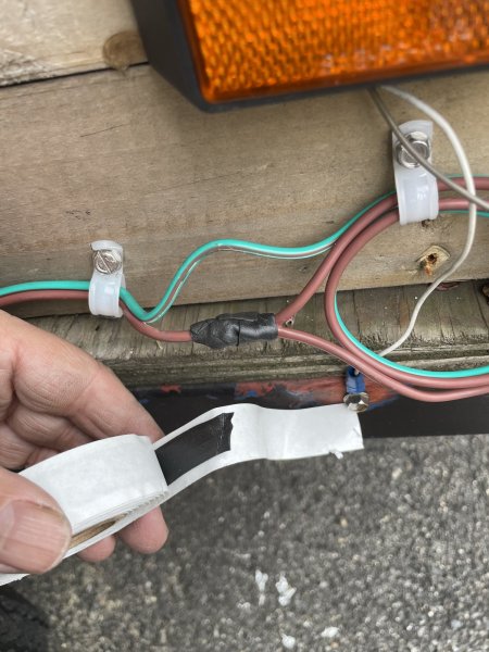

    Since it is a three way wire connection, I pulled out the new Weller and fresh rosin core and made a good physical wire connection! After a good heating then wrapped with the Ham Radio outlet’s best Coax Seal! See pics
