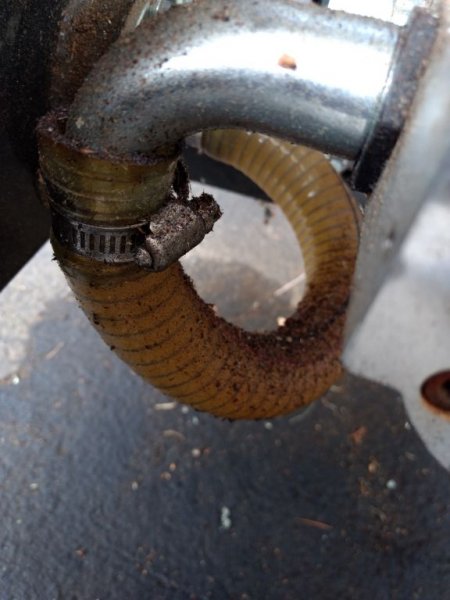

  9. Midwinter
    130,473
    I am concerned about that slow oil drip. It hasn't gotten any worse.

  12. Midwinter
    130,473

    it does look bigger on the ground now. I'll see if I can snug up that clamp. FYI, the weather looks better tomorrow than I anticipated. I might be able to make it there in the afternoon depending on work.

    Hydraulic...a small leak is not a big deal right there...probably a loose clamp as mentioned...
