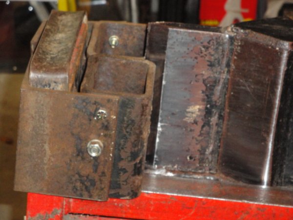

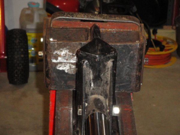

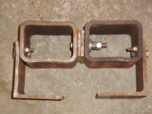

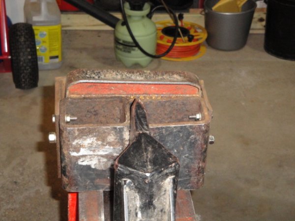

    T.Jeff Veal My original attempt with this 7 years ago, I used bolts to keep it together. The nuts kept getting loose. I eventually got it welded and it works like a champ. These are some pics of the first iteration of it.

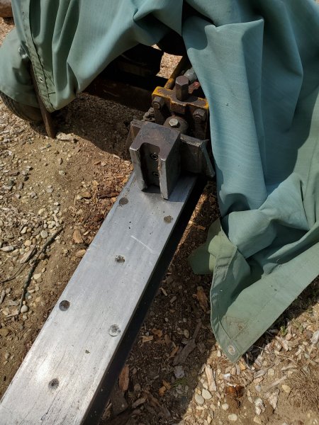

  3. T.Jeff Veal
    29,468
    188,604
    This.^^^..the top of the wedge leaned over a bit.

    T.Jeff Veal I couldn't find the thread either. I am happy someone else finds my invention handy. I find it makes having a hatchet close by not needed. It allows to cut completely thru the round. I use it for all of my splitting. I have had red oak be stringy.
    Let us know how it works for you when you get a cord or two thru it.:handshake:

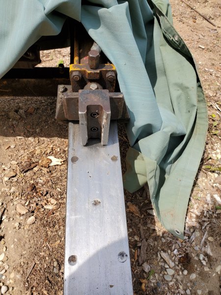

    This is our push through block.
    As you can see it's got a few wedge strikes.

    That's been on it about 40ish years. It was made with just a electric hand drill and a hacksaw. It took a while.
