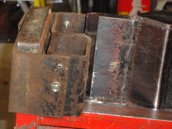

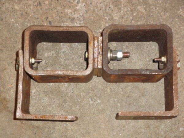

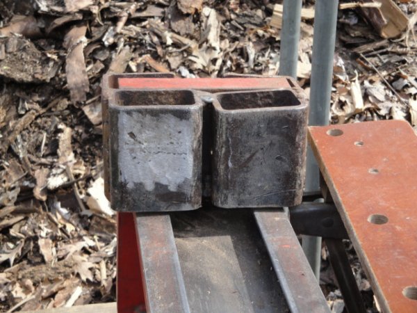

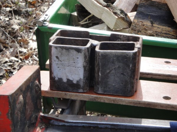

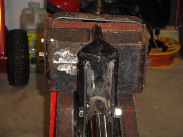

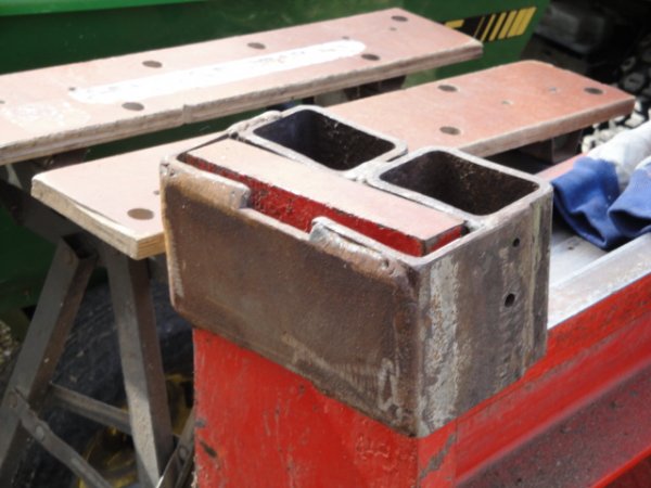

    T.Jeff Veal Stlshrk I have a 25T Speeco splitter with the wedge on the ram. I got tired of trying to pull pieces of wood apart when the wedge didn't go all the way thru. Using a piece of wood as a backer to allow for a full split usually ended up with a backer that would fall apart.
    I have a friend whose step-son is a logger and he had a bent up stake off one of his logging trailers. My friend cut a couple of pieces of that metal stake about the height of my wedge. We found some angle iron and cut a couple pieces the to match the first metal pieces. I had a spacer between the two channel pieces originally that were bolted together. I kept the space between the two channel pieces far enough apart to allow the front edge of the wedge to fit between them with the ram fully extended.
    When I finally got around to having it welded up, a place was added to the other side of the angle iron that would allow it to slip over the base of the beam. Here are a bunch of pictures I took of this project. First 4 pics are of the original version that was bolted together. The rest of the pics show it all welded up.

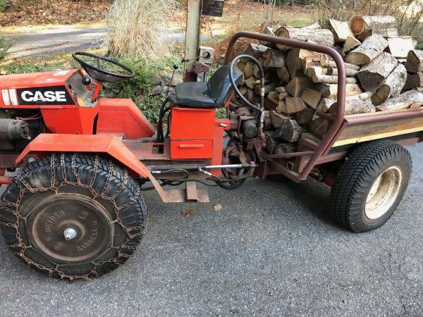

    image.jpg image.jpeg image.jpeg Home made articulating 4 wheel drive Case tractor.
    My best friend, John too. John Deere is my main firewood tractor. Home made 3 pt logging setup with a 8000 lb hydraulic winch.

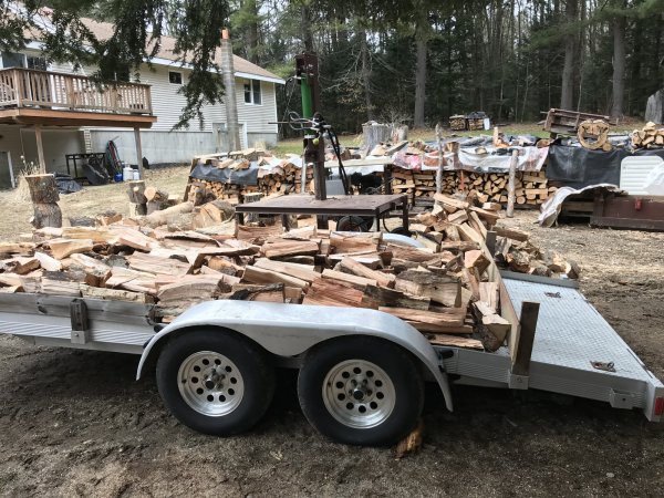

    Main splitter is a home built vertical with a log lift. Table about 4 ft x 6 foot set at waist height.

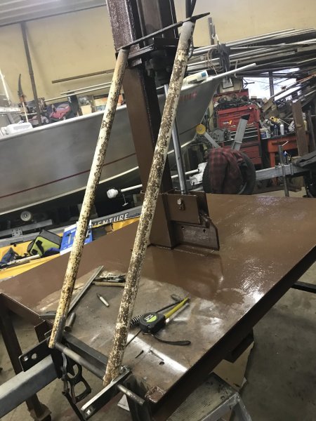

    Vertical splitter pics are construction pics. DE320FBD-FD88-4C76-A8E3-ED609B200475.jpeg 072B00AC-29D0-4D0F-AB13-AFC86CF71D62.jpeg

    Case tractor was just a regular hydraulic drive front steer tractor. Used another Case 2 speed rear end and made an articulated frame to connect them. The Case tractors are hydraulic drive, no belts no drive shafts. Steering is with a hydraulic cylinder. Also has high output and low pressure hydraulic take offs. Rear bed unplugs and a logging arch butt plate slips in with a hydraulic winch. A vertical hydraulic capstan winch is mounted in front of the box bed to haul in small trees etc.
    The frame also swivels to allow the tires to stay flat on the ground at all times..

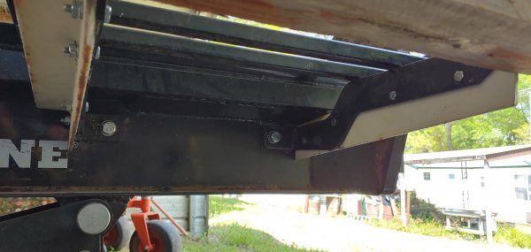

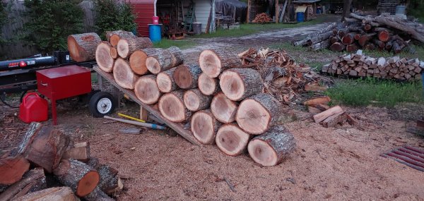

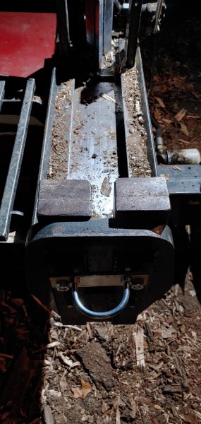

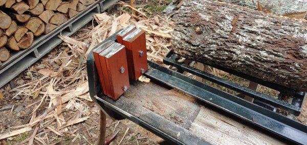

    Did a few upgrades to the 30 ton Countyline splitter. We plan on only using it horizontal if possible.
    First, we added angle iron bracing for the log table. 0405201415_HDR.jpg Then made leg supports for table and ramps 0405201515.jpg 0405201534.jpg Being able to load up ramps, really speeds up the process 0417202020a.jpg

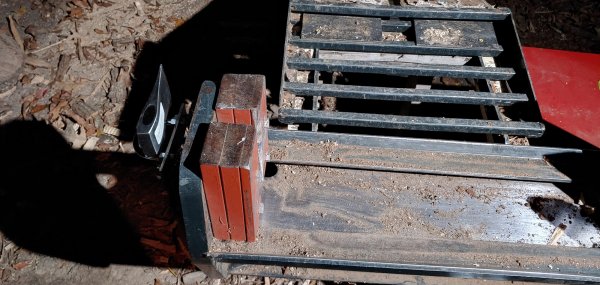

    Then we had some stringy hickory and elm to process, we added stacks of flat bar to the foot, so blade can go past end of the round. 0813201027.jpg

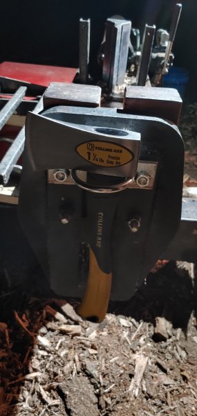

    Today, I got a hatchet to chop strings on big rounds, wanted it to be handy. Used a piece of flat stock and a U bolt, made a hanger on the end of the foot. 1016201941_HDR.jpg 1016201942_HDR.jpg 1016201942a_HDR.jpg
