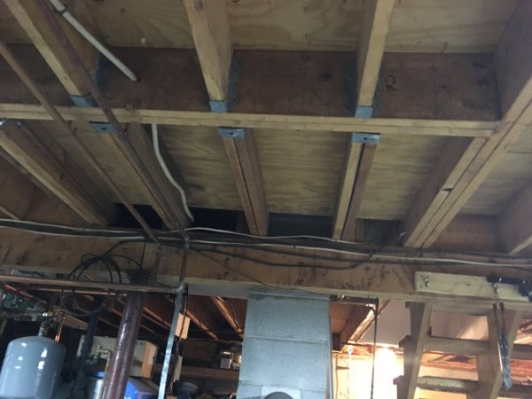

    That is possible there was a field stone hearth at the bottom of the bricks that came out about 40x60 the area closest to the flue is 5 inches lower than the rest of the floor they ripped out the rocks and made fillers to take up the space to make it level up stairs . Picture the brick wall above perpendicular to the chimney
