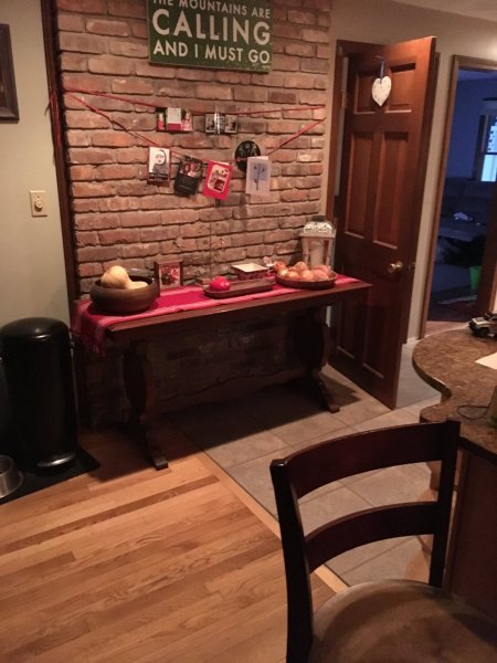

    175AC4B6-B26F-4946-8984-F2A3CA8B3948.jpeg Here is my vacant hearth. When my folks redid the kitchen they removed the old Ashley barrel stove, mom didn’t like the mess and it was way too big turning the house into a sauna.
    For fun I’m interested what seasoned burners would suggest for this spot. My only experience is with pre epa stoves. I have some thoughts but I’ll save them for now.
    The house is a center chimney cape cod. Roughly 2500 sq.ft. The vent will go into the black cap behind the cards. Chimney is roughly 25 foot 8x12 that will have a liner in it. There is a possibility of installing an OAK in this location. The biggest catch is there is only 63 inches between the brick on the wall and the closest point of the counter.
    I have some time as I need to build my wood stash. So it will be put together piece at a time as the budget allows.
    Thanks for any suggestions or advice and playing along with the strange things that go on in my head.

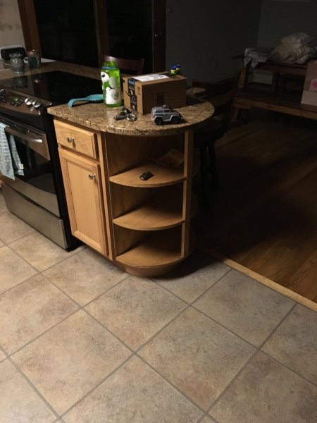

    703F9972-E1F5-4D67-9121-ADD5BA7FC5FA.jpeg Here’s what we’re working with. If cutting the rounded piece off it would put me at 73 inches from the brick to the end cabinet on the right of the stove
    Flatlander Pete likes this.

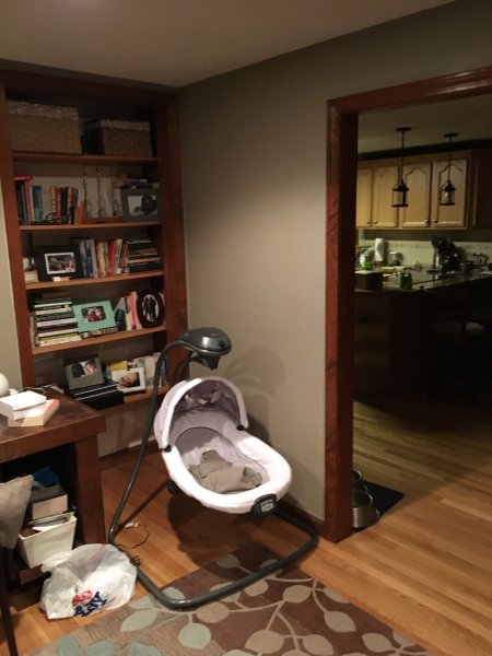

    96900D7A-8C83-445E-89F9-2542CB1AE17C.jpeg The only other spot that the flue would be accessible is on the right side of the book shelf. I’m quite sure the wife would rather me cut the counter than her beloved book shelf.
    Flatlander Pete and papadave like this.

    I don’t see why that wouldn’t be doable. I think your should be able to find a close clearance stove with a rear heat shield that can be within 6” of the rear wall. Figure 24” deep stove plus a few inches for handle etc. and you will have 30” of front clearance and for a walkway. If you cut the counter, even a big stove like the Ideal Steel would fit. It might look massive there, but it would fit!

    I have the IS, and it is a big hunk of metal. That said, the main body is “only” 24” deep and with the door and ash catcher it is 28”. With the rear heatshield and double wall pipe you can be within 6” of the rear wall. I don’t know how much space the heatshield takes but figure 2”? So I am guessing 36” wall to the furthest appendages, plus 30” walkway (and front clearance) would be 66” give or take. I think the AS might be smaller.
