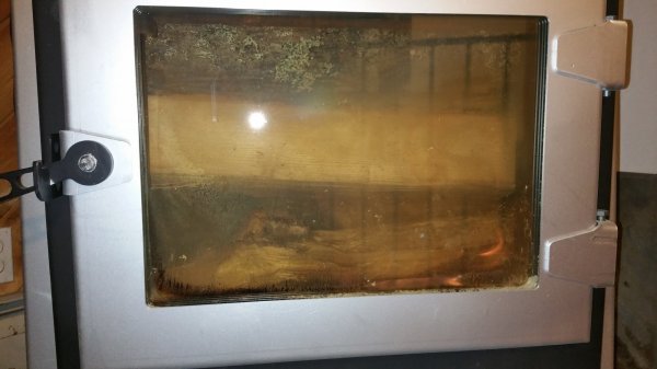

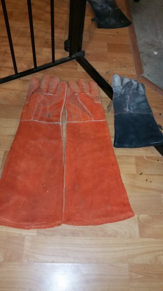

    I found a pair of these come in very handy when loading the up the back of the stove over coals. 1421888460654.jpg Protection almost to your pits.

    I cannot believe you can load for the overnight burn at 8:00 PM. In VT no less! I load at 9:30 and that is a bit too early. Unless you have another source(s) of heat?

    No other source used. I don't even have my t-stats turned on for just in case. Well insulated and large windows southerly facing the length of the house helps alot. The IS is the workhorse. Most days I will still have close to 250* top temp at noon the next day.

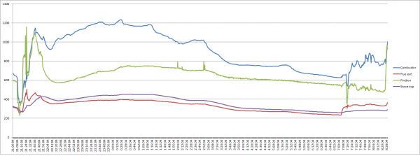

    Yep full- like a squirrel packs an air cleaner in a car :) I load the stove at 9:30 and usually have the fuel charred and ready for overnight by 10:00. Set the draft at 2 or 3 notches when it is above 35F or so and get an outstanding overnight burn with plenty of fire left at 7:30 AM. Set the draft one notch below 1/4 (4th notch) when the temps. drop into the 20's or high teens F. Stove is full of coals in the AM but the house temp. falls a few degrees, stove top is probably around 300 F. When getting near zero, set the draft at one or two notches above 1/4 draft; a fair amount of coals in the morning but stove top is below 300F and the house has lost a few more degrees of temp. Now, I run my house 'underwear warm' which is 73 to 75F in the hallway in the center of the house so it is probably warmer than most people I am guessing. And the worst the temp. has ever dropped is to 67F in the morning with an overnight temp. of 0F and it was still not uncomfortable in here. This stove heats considerably differently than any other stove I have ever used and seems to be based much more in radiating heat to objects instead of convecting heat to the air. The walls and objects in the house are much, much warmer in the morning than they were in the past and the house 'feels' warmer even though the thermostat temps. are usually a degree or three less.
    Edited to add: this is the temperature log for last night until this morning. 21 to 22 Jan temp chart.png
    The reload is easy to see because that is when the firebox and flue temperature spike at around 9:30 PM or so (2100 hours on this graph- it is 24 hour format). The actual woodburning phase can be seen by the combustor temperature, which stays at 1,000F or above until approx. 2:45; the cat. temp. dropoff indicates the wood is basically consumed as well as most of the gasses in the wood. Note also that both the stove top as well as flue temps. decline at this point but the firebox does not drop by as much; this indicates a lot of infrared output from the coals keeping the firebox hot but the stove's overall heat output falls off as seen by the stove top temps. dropping. At around 7:05 AM or so, I opened the draft and partially reloaded the stove at 7:18 or so, note the firebox temp drop off drastically but then basically recover while the combustor temp. rises pretty sharply; this is the combustor 'feeding' on the new fuel (wood gas from the fresh wood).

    That is good information, BDF.
