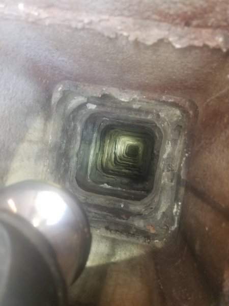

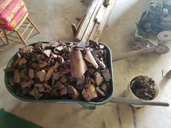

  17. Marvin
    Marvin
    Mar 31, 2018
    2,268
    15,302
    Huntingdon, Pa
    Got my clay liner busted out and cleaned out
    While I was awaiting delivery of the liner by FedEx (which arrived around 130ish) the clay liner became driveway fill. Now it's back to the roof to get the new liner installed.
  18. wildwest
    30,796
    145,586
    :eek: Nice job, win win on driveway fill!
  19. Mwalsh9152
    Mwalsh9152
    Jan 17, 2017
    5,325
    38,830
    Pelham NH
    Looking good! Any pics of what you used to break it up?
