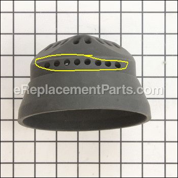

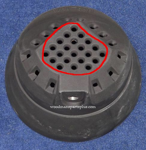

    Looking at the burnpot it looks like they have a few holes above the fire that might be able to get sealed to help flow.
    You could fill most of the holes circled in yellow with stove cement and open all the holes circled in red by at least one drill size.

    I agree that filling those holes may help flow up through the pellets, but the fact that he said it ran fine the first season he had it, leads me right back to the "dirty stove syndrome" or a weak comb. blower.

    I'd start by plugging all the holes in the side that Jay circled.
    Some stoves are known for lack of air and bad burn issues. Baby Countryside, several of the US Stoves, this NS 45, etc.
    I'd still look at the gaskets and such, to make sure you don't have any large burn pot bypasses. As well as getting the larger impeller.

    Thanks Jay, the holes shown in yellow get "buried" along with all other holes underneath the surface when you place the pot in there, It looks like air comes in from there but just at a different angle (not directly from underneath) so the flame it "pushed" back a bit away from the glass?
