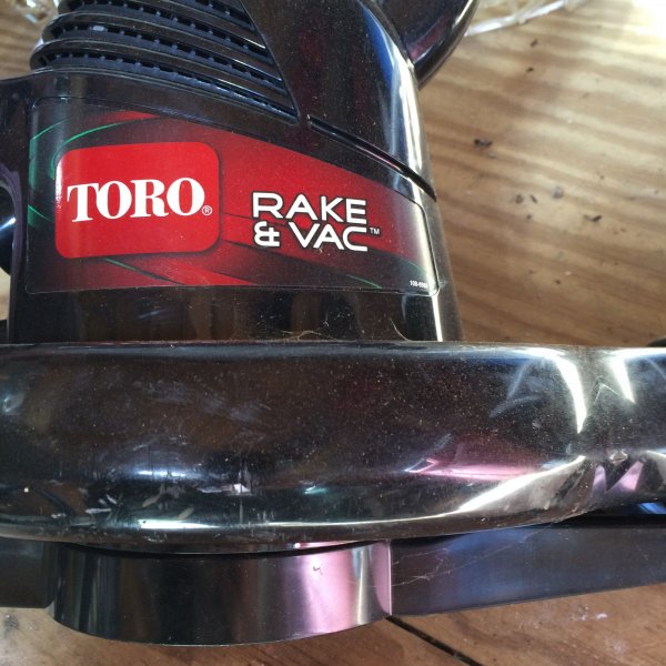

  20. Geek
    Geek
    Oct 10, 2015
    262
    601
    06770
    Here's the big wet/dry vac I use from outside and seal the vent tight with a plastic bag around it, wouldn't this have better force than my leaf blower? (Pics attached too). Never used leaf blower as it may need modifications on the bottom?
