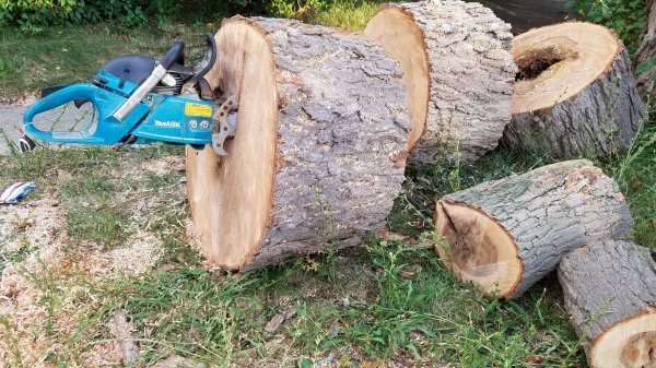

    Carl sold me the 85cc bb kit so I'm not so sure HD will cover anything after that goes in.

    Thanks for the link. The muff mod is on the fall radar. Prob a rainy day I can hang in the garage and play around.
    What kind of portable heat will get that SS cherry red? I have propane and I'm sure that's not enough, will mapp be enough?
    HDRock, clemsonfor and Barcroftb like this.

    It was just a regular propane torch. Orange hot will work. Mapp will work faster.

  5. HDRock
    17,262
    60,487
    Good thing is ya have it .
    You going to try it out before you start taking it apart ?
    Barcroftb and clemsonfor like this.
  6. clemsonfor
    clemsonfor
    15,996
    37,478
    Greenwood county SC
    I would so you can see the difference!
    I would also run the BB kit before the mod then after to see you gains. Really neat to do timed cuts before and after and see actual gains
    Barcroftb and HDRock like this.
  7. HDRock
    17,262
    60,487
    That saw ain't no joke, stock , as is :saw:

  9. A Visitor
    A Visitor
    Mar 24, 2015
    62
    217
    Continuing on the theme, I picked up a Home Depot rental saw this week for a friend that was looking for a saw. $270 plus tax, As Is no warranty. Pulled the cat, general clean up and retighten. Overall a good deal....I'm now an CAD Enabler
  10. HDRock
    17,262
    60,487
    Pulled the cat?
    Clarify!! you pulled the muffler to inspect the Piston or you did a Muffler Mod?
  11. A Visitor
    A Visitor
    Mar 24, 2015
    62
    217
    Muffler mod, just removed the Cat materials- no other modifications. Buffed the muffler for a sharp, if only temporary look.

  12. MasterMech
    9,648
    26,044
    Greenville County SC
    Likely a muffler mod. Job 1 for getting the most out of these is taking the muffler apart and removing the catalyst.
