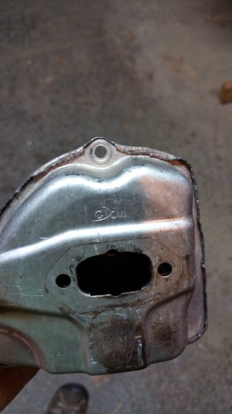

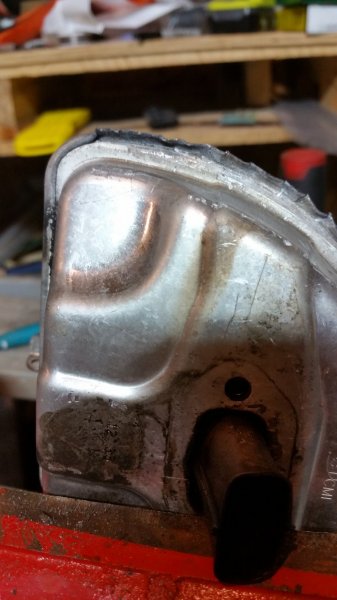

    The title says 7910 but the 6410/6421 should have a very similar muffler. The guts of the muffler may be different but the process is the same. There are about as many ways to split the muffler on saws at there are to swing a dead cat. This is what usually works for me.

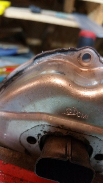

    Dolmar was kind enough to leave us a nice starting spot at the top mounting hole. Heat the crimp and pry it open

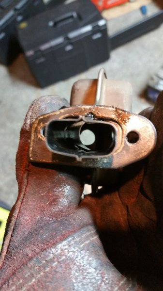

    I heat the crimp to just orange hot. Needless to say gentlemen the muffler will be hot at this point. Welders gloves or heavy leather gloves might be a good idea.

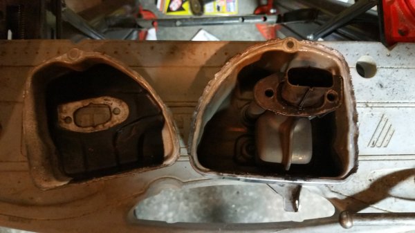

    Pretty straight forward just pry the crimp open with whatever you have handy. I used a flat blade screwdriver on this muffler and pried the crimp open all the way to the bottom edge. From there you should be able to pry, wiggle, swear at, and eventually work the two halves apart.

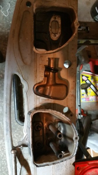

    Next the inner chamber (Dolmar calls this the SLR chamber) should just pull straight out. In the picture below; Top: back half of muffler, Middle: the SLR chamer, Bottom: front half
    You can see here my dealers quick and dirty work around for the SLR chamber is to just drill a couple 1/2" holes into it from the exhaust port on the muffler.

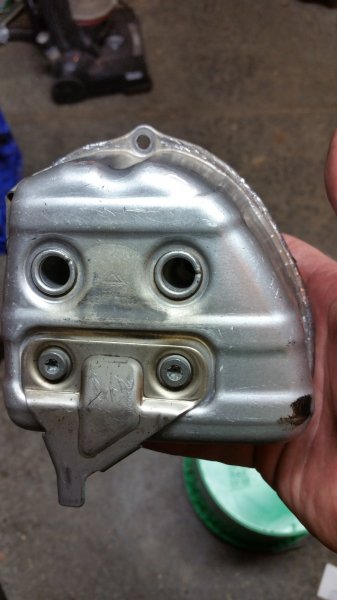

    After you remove the SLR chamber work the two mufflers halves back together. You may need to widen the gap on the bottom edge to make it easier to fit the back half of the muffler back into the front half.
    Make sure the holes all line up and begin crimping the halves back together. You may need to hammer/peen the crimp back over slightly to get it to roll back over. I use channel lock type pliers to roll the crimp back together. Heat may make this easier but I usually just cold roll it.
    I like to start at the top and work my way back down to the bottom edge.
    And there you have it the finished product. All this only took about an hour to do. Hope this helps fellas.

    What do you do, clamp it in a vise just enough to hold it without crushing it?

    Exactly so clamp it in a vise. They are pretty tough.

    Nice right up Barcroftb. I may have missed but I do mine almost exactly the same but the flange around the slr unit is reinstalled I cut the couple tac welds off. Throw slr in trash and reinstall the flange. image.jpeg

    Does that tube go into the cylinder? What side of the muffler is this picture? Does that go to the cylinder side or the muffler side?

    Man Carl I must have spaced out when I wrote that up. I did cut all the extra "stuff" off the flange and put it back in as a spacer. Nice catch buddy!
