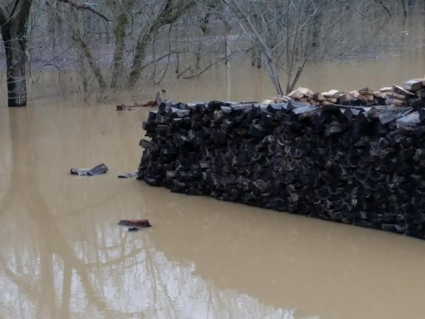

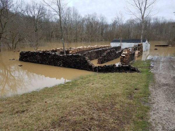

    I lost about 6 to 8 feet off the end of this stack.
    Eric VW, HDRock, WeldrDave and 4 others like this.

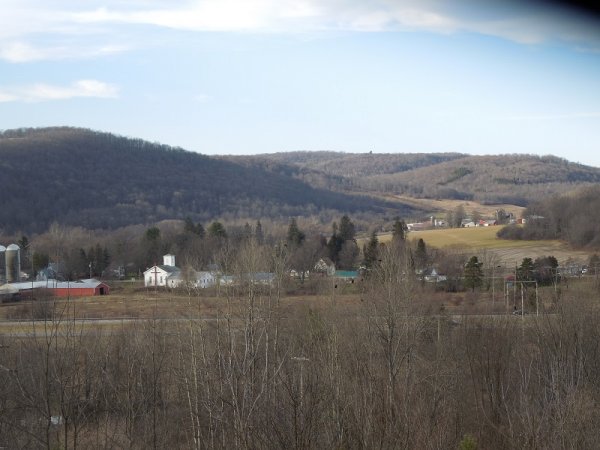

    A couple of pics for reference..
    The high tension power line tower has got to be 100' easy, and is roughly in line with the front yard.
    The highways lie WELL below the base of that tower. If you look closely you can see a bit of the railroad tracks to the left of the tower in the corner of the pic.
    This is a shot of the valley below, you can see the same red barn and church as in the previous pic, and the valley extends northwards. ALL of what is seen is probably around 200' below my front porch.
    I do not expect to see water at my doorstep in my lifetime.

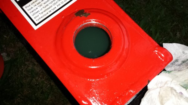

  11. HDRock
    17,268
    60,522

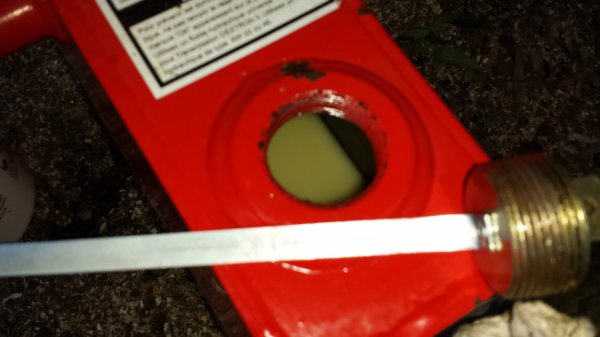

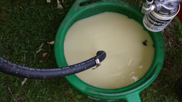

    Sorry to here this news
    You might have water in the hydraulic oil too.
    Below is a link to the thread where I pumped out and changed my hydraulic oil
    This is what it looks like with water in it
    Clean fresh oil
    Changing Hydraulic Oil on splitter ,need some Info ??

  13. Ralphie Boy
    Ralphie Boy
    Oct 25, 2014
    4,274
    29,904
    Rabbit Hash, Kentucky
    Thanks for the information. I plan to have the the guy change it before he tries to start it. He also has an oil disposial company pick up used fluids so we don't have to deal with that.
