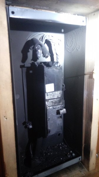

  6. Canadian border VT
    19,806
    132,073
    why I get nervous with older breakers; main power shut that came into my home. Yes it’s fried! Actual breaker is welded open. Now I know it was transformer that went bad and energized this breaker. Breaker should have tripped. Wire over heated caught small part of house on fire. 23? Days without power. If I had not been home would have lost house (replaceable) pets and maybe people (not replaceable). I understand being frugal. In my opinion; electric and flames are not place to be frugal.
