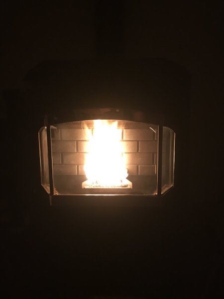

    Just thought I would update you all. Tonight is the first night I've had a fire in the advance in almost 3 weeks since I swapped out the exhaust impeller. Stove is burning so good. Roasting some turmans and it fired up with an awesome flame basement was at 59 and had it up to 70 in no time. Thanks again for all your input. Happy camper here

  10. Lousyweather
    Lousyweather
    Dec 23, 2013
    2,798
    9,040
    glad to hear its running well! cheers!
