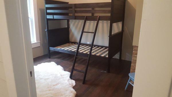

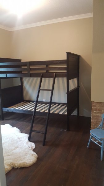

    The attached photos is the back of the fireplace, into the kids room. I am hoping the exposed brick will help to radiate heat into the other rooms. I am hoping that helps those rooms stay warm.

    I have a brick faced chimney it WILL radiate heat..
