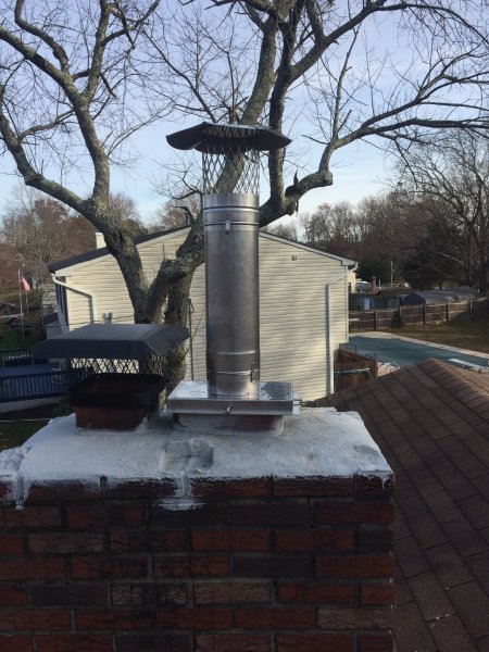

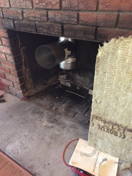

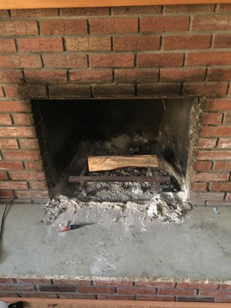

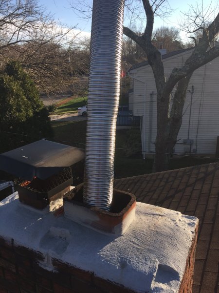

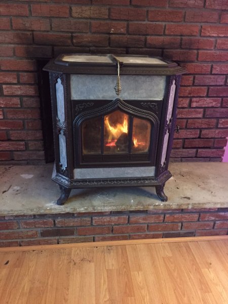

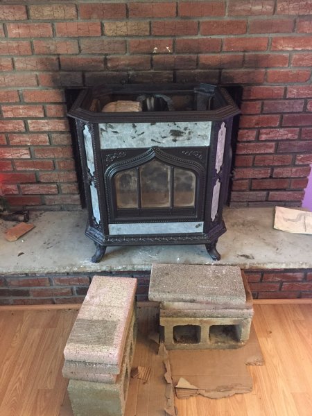

    The Fireview was installed today! I have a small paint curing fire going right now. I'm going back and forth on raising the mantle or putting in a heat deflector. It's 14" from the top of the stove.
    I stuffed some Roxul in the damper (came out easily, didn't have to break anything!) and at the top of the chimney.

    I'm just seeing this thread.. been busy doing my own winter prep clean up work, but NICE JOB. One thing about Fireviews, they are the definition of simplicity. So a rebuild is like getting a new stove as long as you do the gaskets right.
    I love mine. It takes some practice and experimenting to find the right burn settings for "cruise control". I use a small "camping shovel" instead of those decorative fireplace tool shovels to clean out the ash, they are bigger and make the job much less of a chore.
    I got mine as a rebuild, from Woodstock, but it was only a year old, as the gent that owned it needed a Progress for his size house. Tehy are the kind of stove that outlast their owners and stay with a home for generations. You were lucky to get one. I wonder why they sold it. Tell us how it goes as you get the feel for it.

    Heat shield's paint dried and I just finished installing it. I bent the lip upwards in order to hide the screws from view. Painted it black with the same high heat paint that the stove was painted with. Its very discreet with the paint.

    That came out nice.

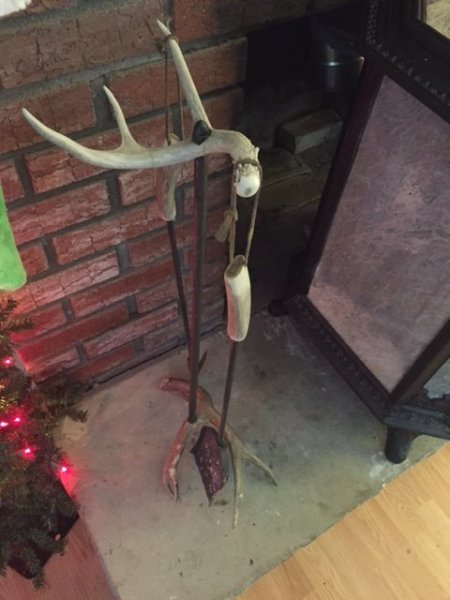

    I almost forgot about this. The person I bought the stove from threw in a pair of antler tools a friend of his made him years ago. I thought they were pretty cool and put them in the basement until the stove was installed. New cat is arriving today.

  13. Oldhippie
    Oldhippie
    Oct 14, 2013
    2,339
    6,733
    Ashby Ma
    Nice but get a bigger shovel for the ashes.
