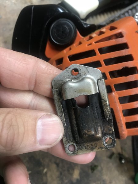

    Previous owner had tried a drill bit in the deflector then fattened the heck out of the carb leaving the inside of the exhaust full of tar. 57E271FD-96CC-4F7D-8FC3-099C4FE2E47E.jpeg It started melting the plastic F93D6964-D122-44BF-8826-1E7F13838F91.jpeg I went for a bit more like this. Used part of the old deflector which is paper thin and a pia to work with and a piece of 3/4” emt. Also removed a fair amount of the deflector. E8E7E4A4-AE50-4542-B82F-7653CFEEA0B7.jpeg Assembled with a bit of plastic massage 1D5188F3-CFF1-4208-A7A9-BC717EDA0F3A.jpeg

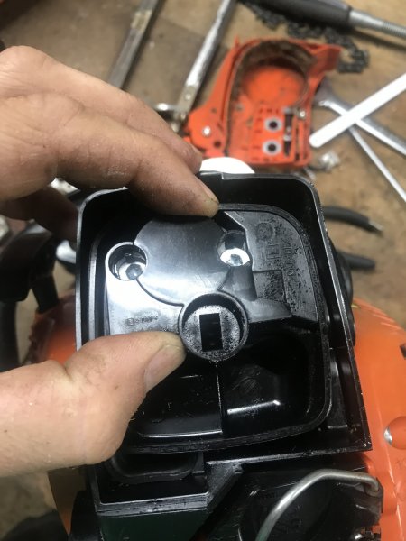

    Figured if it comes out easier probably should see how things go in on the other end. This plastic under the filter seemed a bit restrictive to me so I took it out. EFE26600-5276-4C5B-AEA5-35AB00A64322.jpeg F80A6EE6-188A-4954-B3F0-BD382FCC2C78.jpeg Also under the starter cover there’s a little passageway that is supposed to “charge” the air box off the flywheel. It’s pretty small and doesn’t seem to line up real well so I did some massaging to the plastic in there too.
    Haven’t got the chance to cut with it yet but it starts, revs and sounds great!
