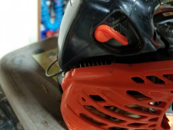

    I really like that the oil and gas caps are full size vs. the dinky ones on the echo 355. And the starter handle can be used to loosen them in a pinch.
    Air filter cover and lanyard ring are well thought out and easy to use.

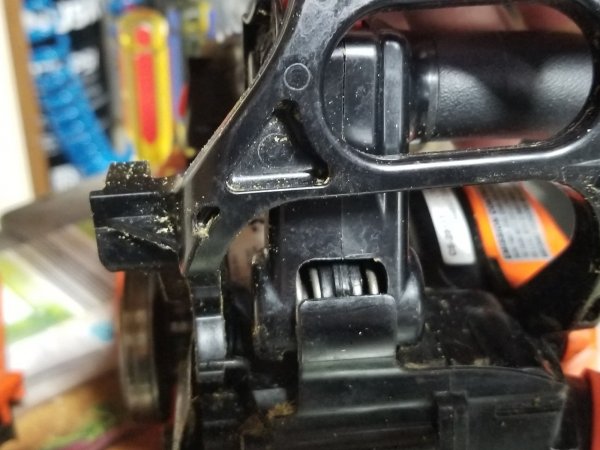

    Echo really went the extra mile with the ergonomics on this saw. Spring A/V has the vibration dampening working really well.

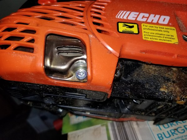

    Just wanted to give a long term use update on this saw. After doing several jobs with this saw it became very apparent that the cat muffler and limiter tabs on the carb were strangling this poor little saw! It was bad enough to make the saw very hard starting and cold blooded.
    Only one way to easily fix that issue:
    I used my trusty dremel to cut some gills in the muffler and pulled the red carb limit tabs with a drywall screw. Overall it's a much happier saw not breathing through the cat in the muffler. Runs much cooler as well and now it starts on the 3rd or 4th pull.

    Definitely! Cuts went from 7-8 seconds before to around 5-6 in that same piece of boxelder. The two cuts at the end I couldn't stall it but before I could totally stop the chain. Unfortunately I lost the before vid during editing. :emb: At least I wrote the times down. I still need to figure out if the 355 dawgs fit this saw.

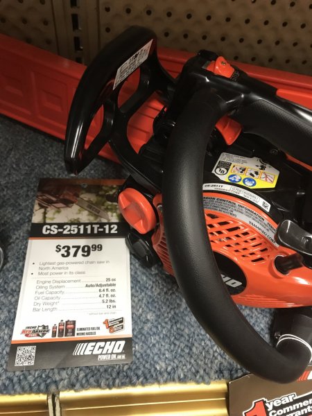

    Local dealer shelf price. What do you guys think? 05FE2757-2501-4F51-AE51-0B89FF31172C.jpeg

    I like that "Made in Japan" sticker. What I don't like is that I already have two Echo top handle units and can in no way justify another (this one). The 5 year warranty surely is attractive!

    Seems a tad salty, but the last time I was in an Echo dealership is when I bought my 355T, that was around 4 years ago IIRC.
    It was 400 bucks out the door.
    Do an Internet search, check Amazon and fleabay.
