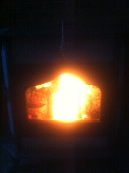

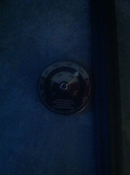

    I think I have found the air setting that "pushes" my stove as far as I am comfortable pushing it. Normally my stove will go up to 550 SST with a 1.1 air setting; doesn't seem to matter if it is black cherry, american elm, or white/red oak. Over the last day I have been running at 1.25 air setting usually loading 3 splits getting same STT. This morning loaded 2/3 full of elm and cherry and went all the way to 600 STT. Outside temp is 14 and inside is 74 and climbing. Any higher air setting and I think the andirons would start to glow.

    Not to worry HM
    You wont get them glowing. I had a fire go nuclear the first year, It was almost to 800* STT :bug:
    Normal Operating Temperature
    for the FV is 300-700* STT as per WS's owners manual. And that is considered safe burning for every day use.
    My 800* temp scared me at first and I wouldn't recommend it, but I guaranty those stoves have been tested to to see what the limits are.
