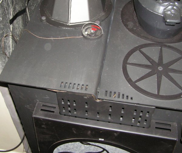

  7. BDF
    BDF
    Jul 22, 2014
    2,160
    7,532
    Virginia
    It sounds like you are reading the temp. on the outside of the stove pipe, not inside it: if that is the case, as a general 'rule of thumb', the internal temp. of the flue gasses will be double the temp. of single wall stovepipe. So my 650F max. is really 325F on the outside of the pipe. If your pipe is reading 400F, your flue gasses are more like 800F.
    As far as the mess of wires, three dark brown wires less than 1/16" in diameter is not so bad, is it?
    They look a LOT more obvious in the flash photo than they are to the naked (Easy Boys!) eye in any normal room lighting. So does the dust on the stove; believe it or not, I vacuumed that thing of two or three days ago and it is pretty clean to the eye but every speck of dust shows up in a flash photo. The large, black wire is nothing to do with temp. monitoring and is actually the 115 volt supply to the draft inducer.

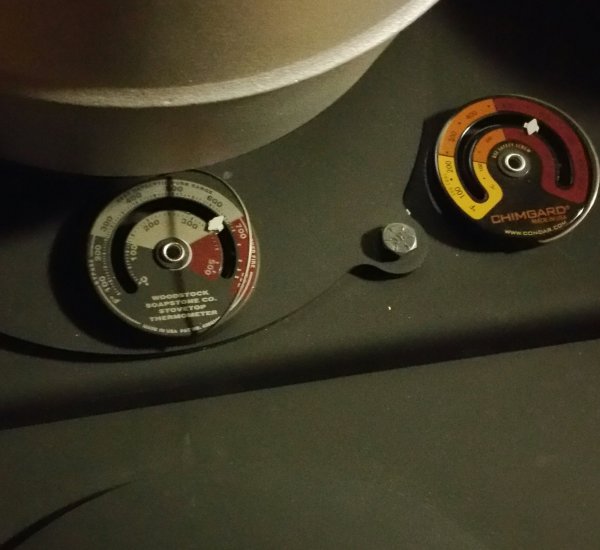

  12. Hollywood
    Hollywood
    Oct 1, 2014
    228
    381
    Jut talked with lorin from WS. This is not over fired. The IS and there other stoves have been known to get into the upper limits when conditions are right. It's OK if they hit this mark but it is not reccomended to maintain this temp for extended times. A safe crusin temp measured near the flue collar is 600* with SPIKES of higher temps is not considered over firing. 20141231_233818-1.jpg 20141231_233936.jpg The primary temp measuring spot is next to the flue or on the flue block off plate.

  19. My IS heats my home
    My IS heats my home
    Dec 1, 2013
    7,394
    17,655
    Albany, NH
    What are you burning Hollywood in the second picture??
  20. Hollywood
    Hollywood
    Oct 1, 2014
    228
    381
    I only have maple. That pic was about 2hrs after I cut down the draft.
