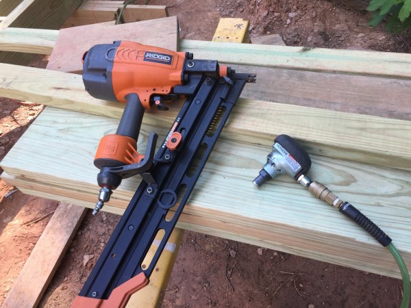

    cnice_37 heres your grunt
    I have little brand loyalty on power tools
    This little hitachi palm nailer paid for itself on the hurricane ties
    Cutting implements old Black and Decker Circsaw has been through the ringer big 10-1/4 Milwaukee for posts, Milwaukee sawzall, Metabo grinder with polyfan for tuning down the high spots and a hand saw for when that's all you need.
    Drills impact driver is hard to beat when you have a bunch of screws to drive.
    12" sliding compound miter bought this when I resided the house with hardieboard it's earned its keep

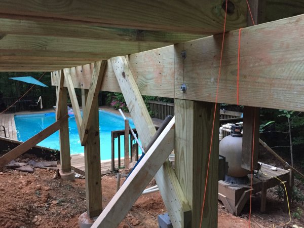

    basod are you planning to cover the joists with any type of flashing?
    I love building decks -- sort of like treehouses as a kid.
    Edit: I was just looking back at some photos.
    WRT this one: Deck build
    It looks like you've attached your beams to your posts using only through bolts. Does this comply with code in your area?

    Yes they are setting in notches on the posts
    Depth perspective doesn't show that:handshake:
    2x6 bracing is forth coming for lateral loads

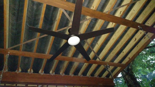

    For those wondering, the black stuff is EPDM that drains to a gutter located on the far side of the beam. There's also blocking directly above the beam but its hard to see because of the EPDM.

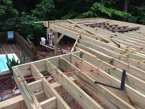

    IMG_1197.JPG Skies cleared for a bit. Squared off the left corner and added the 45deg breezeway. With out this when the screen porch is done there would be a tiny 2' connection on the two outer decks
