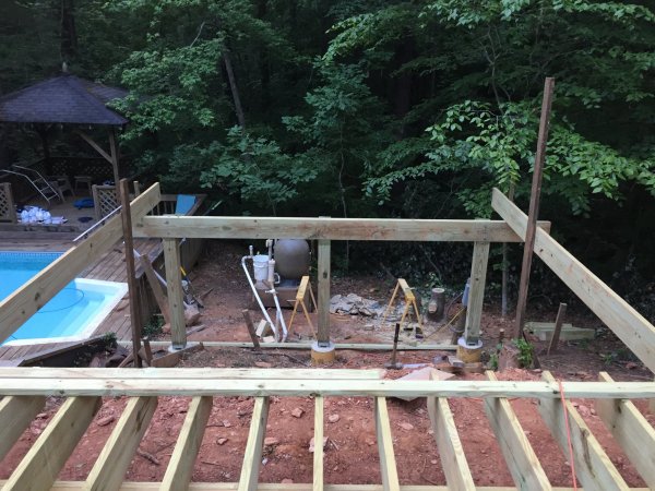

    No it's a 300lb sand filter, I use 2cups of DE for a polishing aid. Shop vacuum it out into totes moved reconnect plumbing and refill with sand. Took a few hours, repurposed one of the stair landings with some extra knee braces for the platform. It'll get a permanent home under the new deck when completed.

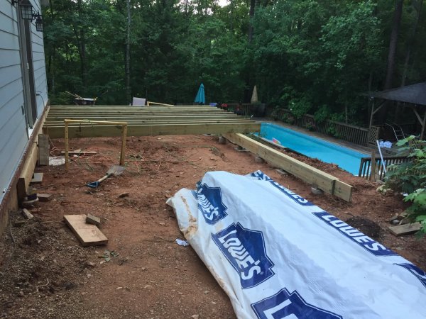

    IMG_1169.JPG Starting to look like a deck. Beam nailed off and secured. Set about half upper joists. Might need to update compressors as my pancake is struggling to drive 4-6 nails with the palm nailer... of course using full 3-1/2" 16d on the joists. It might be ok when nailing 1.5" on the hurricane ties or I should have bought an MCN years ago

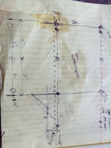

    Possible future screen porch here's my layout

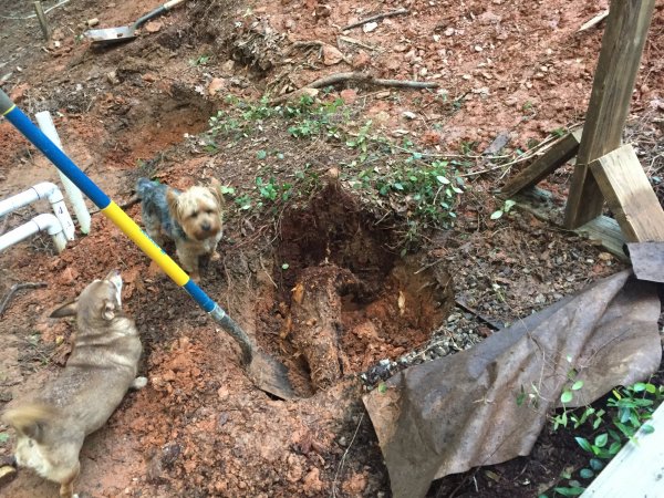

    IMG_1176.JPG IMG_1177.JPG Upper joist all set and hangers nailed off.
    Temporarily braced the outer rim joists and started digging the other three footings...
    Hit a half rotten pine stump on number 1
    And some 2-3" roots on the others

    :salute: You use the same kind of detailed plans I use for my projects. :thumbs:

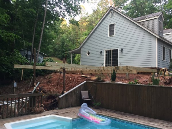

    IMG_1181.JPG Plugging away. Had to let the footings setup another day, got the posts and beam set this afternoon worked on blocking for couple hours each evening while waiting on cure time.
    Need to make up my mind on decking, starting to lean towards 5/4 vs. 2x6. Changed my mind a couple times on railing posts from 6x6 lapped inside to 4x4 outside with chamfered corners

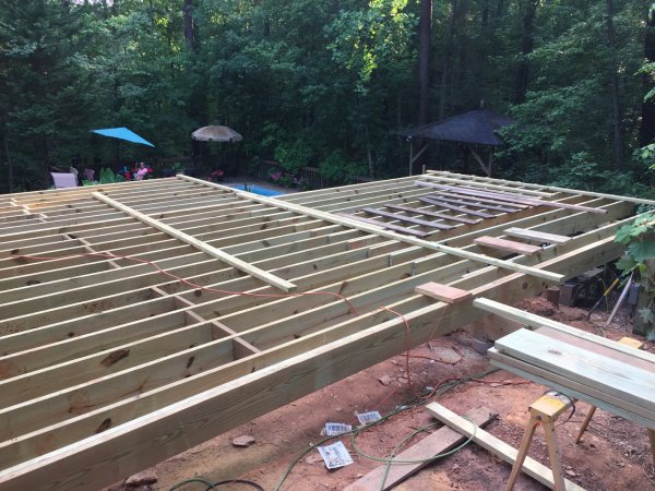

    Outer section joists hung, beam finished and footings back filled squared off ready for blocking and bracing.
