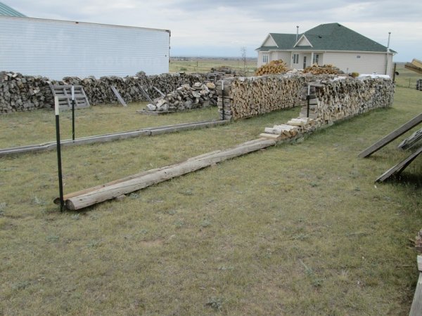

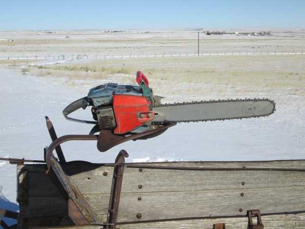

    Found the pic of the pole and the saw.

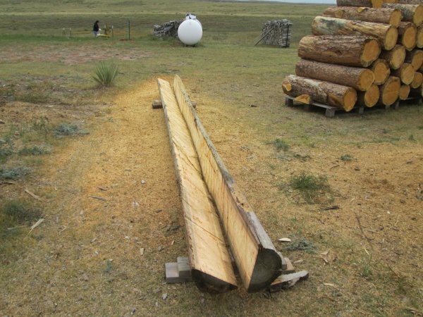

    Just out of curiosity, did/do you scribe a line and walk up and down the log or cut completely through and proceed down to the other end? I’ve never walked a scribed line before and just trying to imagine what would be best for a newb.

    I ran a chalk line then I took the saw and ran a scribe line down the chalk line with the saw. Then I went back and cut all the way through. Not perfect but I least I had something to follow or else it would have been as crooked as a dog's hind leg.
