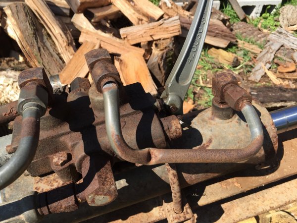

    The last picture is one of the lines. Do you think it would be possible to replace that with another hard line or a rubber line?
  4. tree killer
    tree killer
    Mar 14, 2015
    2,463
    16,916
    Central me
    Unscrew the 90 out of the valve body and the fitting at the other end of the line. Take it all to a local place that makes hydraulic lines. They can make a hose and give you the correct fittings to change over to rubber. Just remember rubber is flexible and won't break like the steel lines do but they need lots of room for bends. Best bet is to get 90s and run a straight hose. Many places can make steel lines but it's a lot more expensive.

    Just took a closer look at the photo. That's easy, just new fittings on the valve and cylinder and a short hose curved around the handle and you're good.

    possible yes, getting connections right might take some time! oh if your like me take a stick welder and put some x marks or dots on push plate keeps ones that are not perfectly straight cuts something to grip... you'll be glad you did:yes:

    when you replace that bad section, change your hydraulic oil, and follow these instructions (post#8) in this thread, to make sure you don't have air cavitation ( trapped air) in the system.

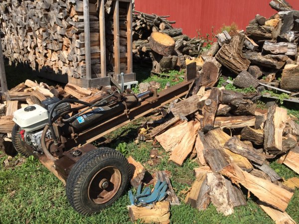

    Post a close up of the tag on the cylinder. Looking at it, I'm 99% sure it's a didier.
    Good deal on picking it up.
  10. Horkn
    29,204
    166,691
    Yeah, doing à little poking around on the internet tells me it's a didier. Plus, I've spent quite a bit of time with the didier my cutting buddy owns.

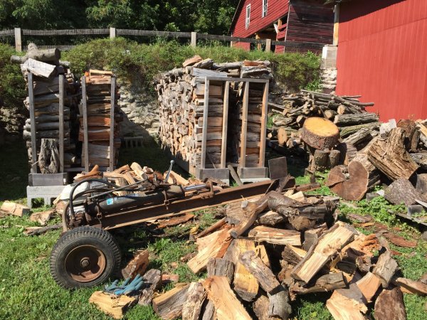

    They look fine to me too. All they really need to do is not be flat. The splitter is small enough to load into a pickup truck, or in a small lawn trailer. Most suppliers are not designed for much speed anyway, if hauled behind a vehicle on the street.

    zooming in with my tablet on the pictures I don't see cracked side walls or anything like that, look like good rubber

    They are cracked up pretty good but I made it home. The part that worried me the most is it being so small that people may not see it when they pulled up behind me. I don't think I'll be towing much, just around the yard.
    I take a picture of the cylinder tomorrow. Should I put grease on the beam, where the ram slides?

    Well pictures are deceiving, the best thing for sure splitters, is to not tow them on the highway at all, trailer or truck em:)
