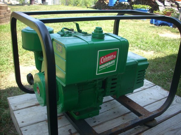

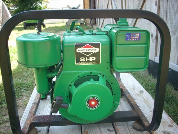

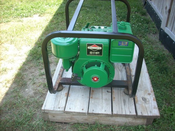

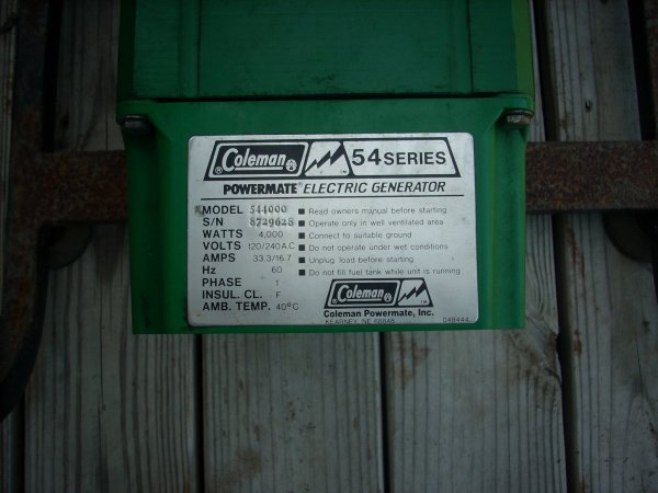

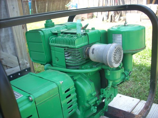

    Hey gang, Today after Breakfast I was scanning the tools on Craigslist and saw this Coleman generator, it said $50.00 :eek: I thought it was a mistake so I got a hold of the fella and he said, "nope" it's $50.00 and only because we haven't heard it run since 1992.:eek:o_O He said his Father passed away last year and they were doing a garage cleanup, it has never left the garage since new. I said, ok I'll come look at it. It was in pristine condition other than the frame rusting a bit from ocean air. It had "Great compression" but no gas at all in the tank, not a drop!!! That scared me a bit "But" I gave the man $50.00 and dragged it home... Taking a chance, I sucked out all the old oil and put in fresh, added a couple caps of marvel mystery oil to the tank and some fresh gas, a little gas in the carb and it "Fired up" on the fourth pull!!! :jaw::D:cool::tears:. It's only downfall is, it's as noisy as a small locomotive. DSCN3102.JPG DSCN3099.JPG DSCN3098.JPG DSCN3100.JPG DSCN3101.JPG It's 4000 watts and it ran like a banshee:banana:. After I let it run for 10 min I checked all the outlets and she has plenty of power. I took a chance and "this time" I didn't get burned... :)

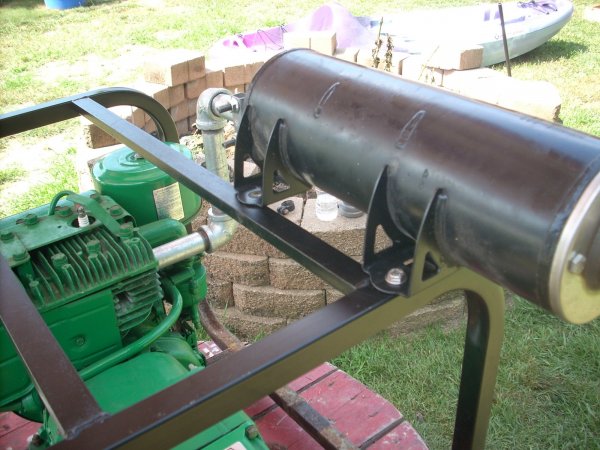

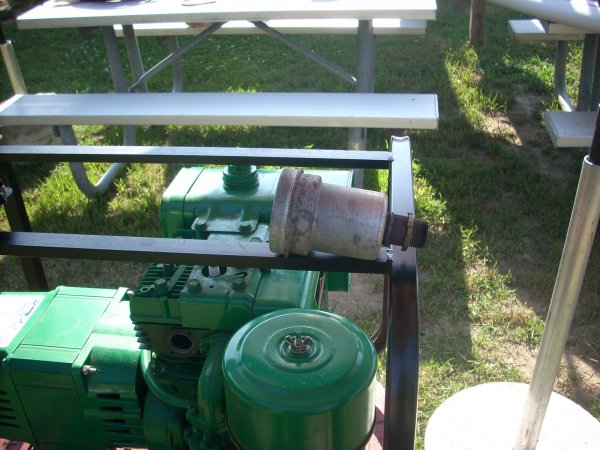

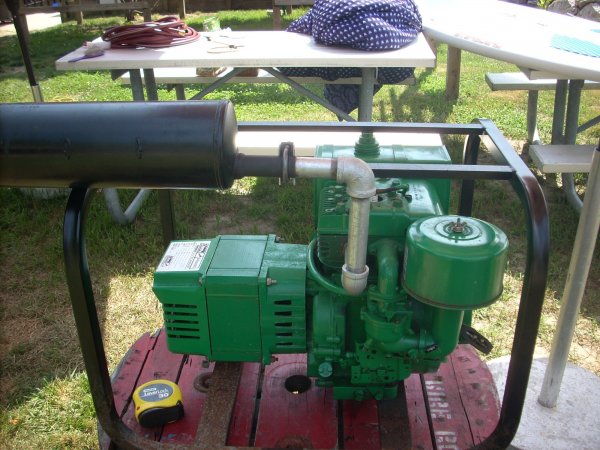

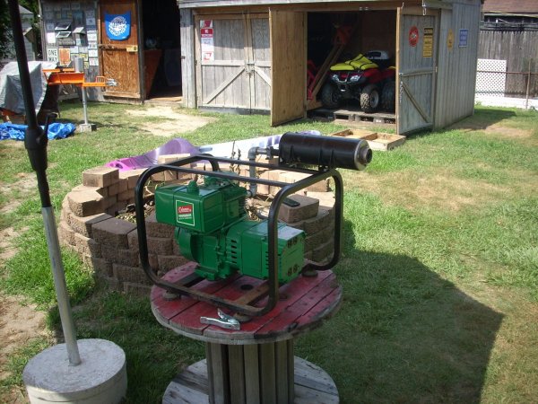

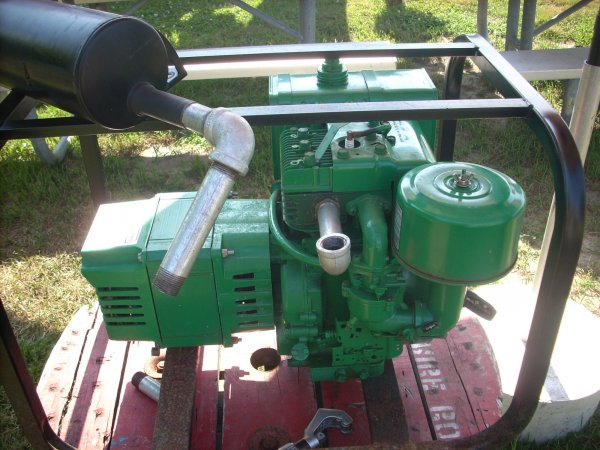

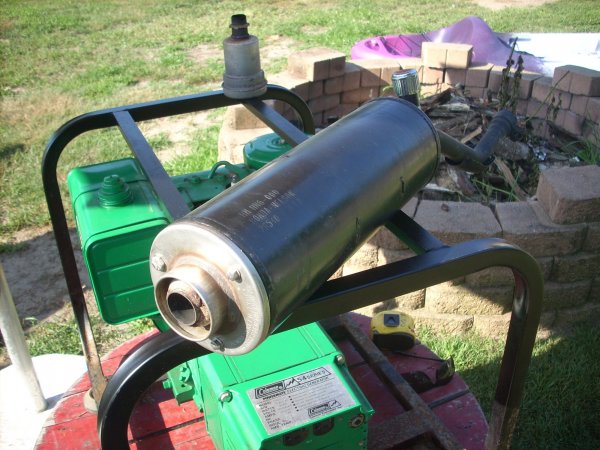

    Ok, this morning I had my coffee and then the cog kicked into gear. :confused: You know those things we "Never throw away"? :whistle: We might use some day... :whistle: Well, I had remembered about two years ago I put a new performance exhaust on my Daughters ATV and kept the old muffler... :D:tears: so what did I do,..... 2 hours later and a $1.60 for a 1-1/8" muffler clamp I was in business!!!! :banana:
    I had all the extra pipe and the things from my gas stove installation, it was like Christmas.:santa: And, I can say I believe it knocked the noise in half. It's at least tolerable from a couple feet away.
    I just got to make sure the cords are plugged in before running it, DSCN3108.JPG DSCN3107.JPG DSCN3113.JPG DSCN3114.JPG DSCN3115.JPG DSCN3116.JPG But it worked perfect.
