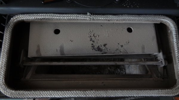

    Here's an old pic with some of the Ideal's flakes, showing up as darker flecks in the white ash, like the three on the left by the loop of small gasket material, with more over to the right. For those not familiar with the guts, the cat is pulled up out of position, and the heavy steel plate that sits over the cat (and flakes off oxidized steel) is out of the stove, probably sitting on the floor by my feet.

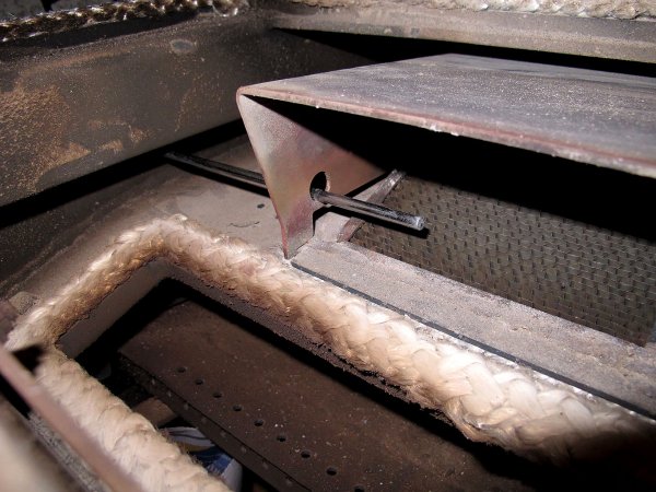

    Here's another of the Ideal, with a few of the flakes on the top in the center (most flaking occurred underneath). This photo was to show Woodstock how the shield had shifted from the sled moving back and forth - I think they changed its "feet" a little after that.

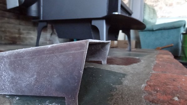

    The Absolute shield didn't flake. Here it is in February (sorry for the orientation)...
    ...and again in mid-April, now showing slight signs of warping.
    {edit: This was a beta version. The Absolute's production version has different "feet" and the hole for the cat probe.}
