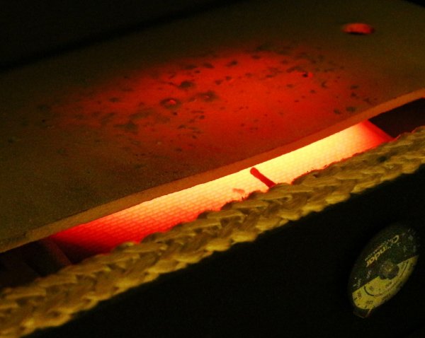

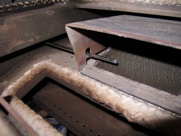

    Yeah the 4" is just about right on the IS to get it over the edge of the cat but any further would contact the mechanism that moves the cat 'sled' back and forth, on mine there is only about 1/8" of gap at the end of the probe. You can't see that in the pic though, only when the cat handle moves.
    Cat working and 4" cat probe on the IS (above the front door). Going to be different for the AS of course, if nothing is moving in the way though should make things a lot simpler! You can see the radiator sagging and scaling too with all the heat of the cat. I wonder if the AS will have similar issues. I know the new radiators have stainless shields to help with the scaling but not sure how long they'll last with the sagging. Might not be very expensive wear item, I didn't ask, they are replacing my current one for free.

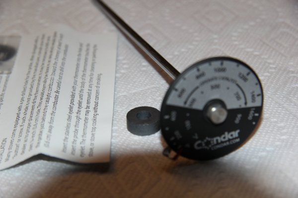

    So I picked up a Condar CAT Probe from the nice folks at Woodstock, all cut to 8" length. It comes with a nice little probe washer to insert into the threaded outside wall of the stove once the stove nut is removed, and it also came with a round magnet that I'm trying to figure out where to put that? Any ideas? Inside stove wall?
    Not sure what the magnet is for. Any ideas guys?

  6. Babaganoosh
    Babaganoosh
    Sep 7, 2015
    1,137
    3,828
    Jersey Shore
    I'm gonna guess you hold it against the stove and the push the probe thru that and the hole in the stove. The threaded hole is slightly larger than the probe so there's a bit of probe wiggle room.
    Just my edumacated guess.
  7. Oldhippie
    Oldhippie
    Oct 14, 2013
    2,334
    6,697
    Ashby Ma
    The elongated stove washer upper right in 2nd pic, in the plastic is for inserting into the threaded hole where the bolt is removed. But the magnet has me confused. Directions say nothing about it.

    I've read that guys use those magnets on the IS, between the stove body and the thermometer dial. The IS probes are a little loose in the hole, so the magnet holds it in place. I run mine without a magnet, but have considered trying this.

    On the IS that insert (elongated stove washer as you call it) doesn't fit into the hole when you remove the bolt. If it's the same as the IS then I'm correct about the magnet.

    Yeah usually the probes are just a loose slip fit into the hole, the magnet holds the unit to the body of the stove better.

    You guys are so smart! No wonder I hang around here. :)
    That little insert doesn't fit the hole and the magnet does hold the probe dial to the stove nicely. About a 60 sec.install. :) I'll take a pic or two before I start the stove a bit later.

    Here are pics of my probe install.
    It took 5 minutes once the probe showed up at my door. Just remove the small "probe bolt" on the left hand side of the stove and insert the probe. I bought this one from Woodstock, cost me $40 with the shipping.
    This is a pic of the install and my first fire afterwards.

    Looks like a nicer solution than the IS since the cat isn't on a moving sled and also enough room to have the probe dial oriented properly and still be able to read it lol.
