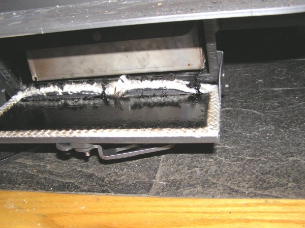

    Just tripped over these photos of my own ash pan door when it was covered with black, sticky creosote. It looked like this:
    As you can see, there was so much of it it bridged the bottom of the door and left strings like chewing gum when I pried the door open. And then it pulled the gasket out of the slot. Pretty nasty mess but easy enough to scrape the big chunks off and keep going. I never did bother to actually clean the door because it just did not need to be done IMO.

    Several people have had this happen on an I.S., the most recent I believe was Darin (My IS heats my Home).
    The ash pan area is very cool, and when the firebox is also running on the low side, it makes a lot of smoke. When the smoke goes up, the combustor burns it.... all fine and well. But if it can drop down into the ash pan well, it condenses the creosote out of the smoke and leaves that wet, shiny, sticky, stinky mess in that photo. The way to avoid it is to either run the stove harder or to keep a layer of ashes over the grate so the smoke cannot go into the ash pan area in the first place.
    The good news is that it does not have to be cleaned up as long as the gasket area is clean (and mine was not but I only cleaned that area). I honestly do not care HOW much creosote lays in the ash pan well unless it is so much I can not remove the ash pan, and that would truly be a lot of creosote. But that is the stuff that also builds up in a chimney and causes chimney fires so it serves as an example of how fast and easy it is to build up that stuff; what is shown in that photo happened with less than three loads of wood through the stove.

    Interesting. I believe the design on the current production IS is the same as the initial release stoves?
    I've had issues in past stoves where the ash pan area gets gunked and or gasket pops off when you open the stove. Frustrating. I learned the hard way to not load and do ash at the same time in case of a gasket problem!

    That is the beauty of a cat. based stove (pure cat. or hybrid), they can run cool and produce a great deal of creosote and yet not send much if any up the pipe. The firebox is black but the stack is clean.
