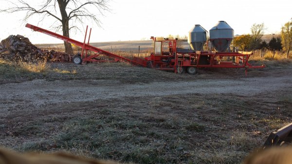

    My father in law hires one once a year to split wood for his outdoor wood boiler. Works out great for him, I think the guy charges $100 per machine hour. He is running a new Blockbuster 22-22 and has a 4,6, and 8 way heads for it. It is a awesome way to work up fire wood. We usually have him on the farm for 8 hours and with good logs that gets the FIL 10 cords or so. 20141101_080939.jpg
    My father in law just about bought one this year since it is so hard to get this guy, the owner of the processor delivers 20-30 full cords a week from September till March. That's roughly 750 cords a season!
    Let me know if you have any questions.

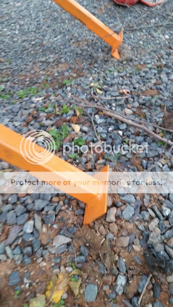

    I built some pretty substantial feet for the machine, so they really dig in under load and the machine stays rock steady
