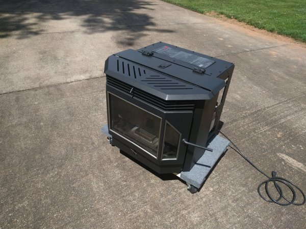

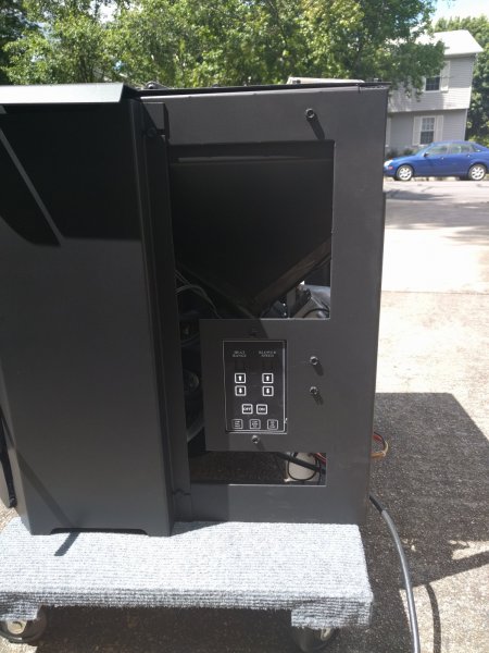

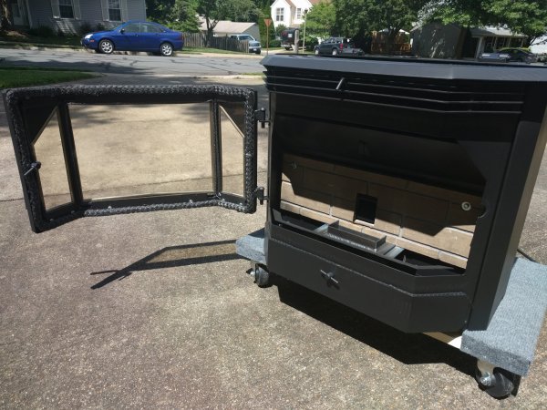

    There's really nothing I can complain about as far as "cosmetic blemishes". If I was hyper-critical, yes, but I'm fully satisfied with the appearance. Initial functional test is promising, although I haven't seen indication of the automatic ignition firing up (pun somewhat intended). It was outside in the sun, though, so I moved it inside facing the garage door so I can do the operational test once it finishes the shutdown process since I interrupted power to it.

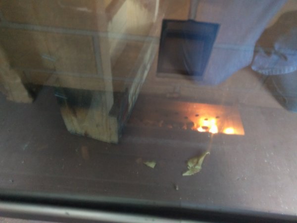

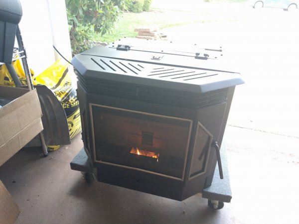

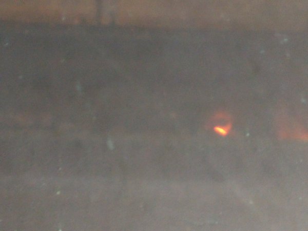

    Igniter warming up, pellets catching, startup-mode and then settled.
    The first run through the stove generated an E-2 (burning/flame not detected), but I think it was one or both of the auger tube not being full or old/wet pellets.
    Physical inspection and functional test complete and acceptable.

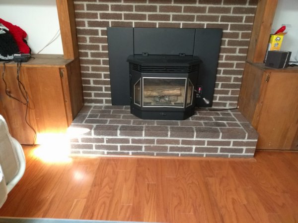

    That was a pleasant suprise.... Not only were the contractors on-time, they over-estimated labor and the install was $400 less. Somwhere around $2,500 total for the Englander and install. Literally 1/2 the price of the original quote for a new Empress getting installed. The install included new 3" and 4" venting run up through the chimney and a new chimney cap.
    The only negative is the surround. The way it's designed it looks like the whole stove has to come out for cleaning and mainteance. The panels are screwed on from the "inside" and they can't be individually removed for side access.

    Looks good! Is it hooked to a T-Stat? Is there a GOOD surge protector hooked to it?
    As for the cleaning, I'm guessing that the unit should be able to be cleaned fairly well w/o removing it, based on what I read in the owners manual. That would probably be during the end-of-burning-season cleanout. Is the chimney cap accessible to you to use the LBT?
