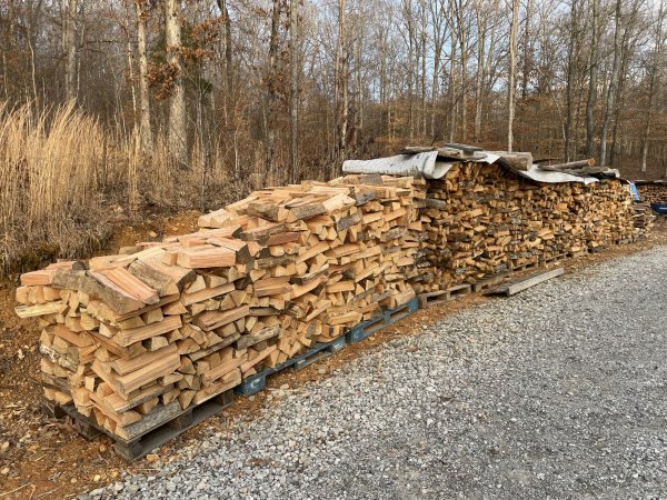

    This load was cut six days ago and is primarily white oak with some hickory and beech. All below 20%. Same age as the red oak. 5E87828C-B7E6-40F2-B4C8-2F11C93CB608.jpeg

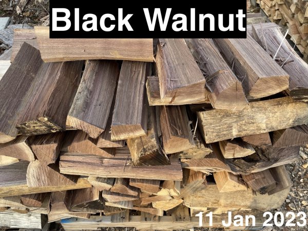

    To muddy the water more, the 56 12’ logs I purchased that are sixteen months old from timbering consists of red&white oak, hickory, beech, black walnut and a little yellow poplar. All are within 18-22” in diameter. I tested all the types the same day of cutting and splitting. From high to low: red oak, walnut, hickory, white oak beech and poplar. Was surprised the walnut was reading 22-24% since it looked very dry. Have found 3-5% moisture levels decrease in the first week from splitting to selling size. DC359D72-63A2-4859-A36E-9493B621E636.jpeg

    I only had walnut once about two cords from a tree job.I was surprised to see after a year of drying this wood still didn't burn well.
