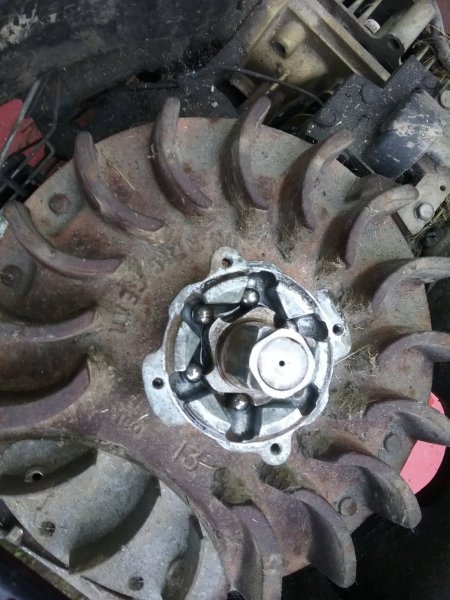

    Sounds like the pawls aren't extending out. Take the recoil off and have a good look-see....

    Do a Youtube search for "how to fix a starter clutch on a briggs and stratton engine", and the rope starter itself is probably fine.

    True. First, take off the flywheel cover. There should be a 4 cornered crankshaft extension with a small hole in the end. This is the starter. Oil generously and flip the mower over on it's side (carb up). Try spinning it with your fingers. If there's no grip on the crankshaft your balls are stuck. Rotate the starter SLOOOOWLY so the oil can get all the way around. Light hammer taps may loosen the balls up. Ladies go easy. If that doesn't work take off the screen and gently tap on the lugs that the screen screws go into and turn off the starter. It turns off counterclockwise when you're facing the flywheel side of the engine. Replace the starter if oil and a big hammer doesn't loosen it up.

    Yup, it was my balls! All cleaned & oiled up now, thanks!

    Had to clean those many times to get it working, actually you don't want any oil in there. fine dust will get in there and gunk it up again. I always left em dry.
