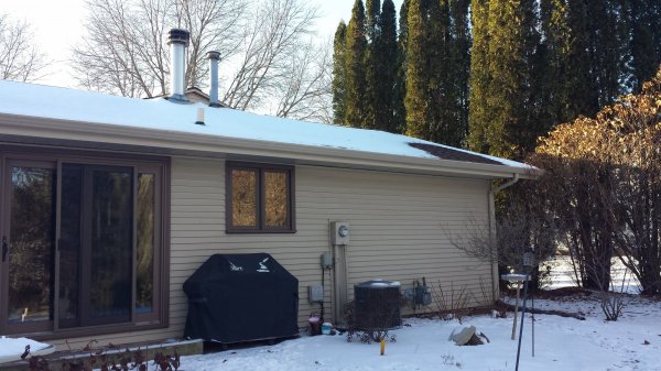

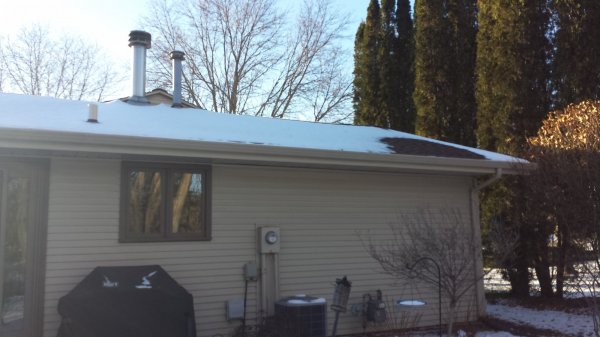

    Ok.... so after one and a half years of baby sitting my insert I think I have found the problem...bad Draft conditions. I have had troubles with burns with 15% Mc they always want to go out. So this fall on a dead calm evening the fire was burning great cold front came through at 9 pm and struggled till 11 and pretty much gave up. See the pictures for chimney set up. I ordered a vacustack today and think it will help my issues. The cedar trees are north and my house sits on top of a hill with it slope in the front yard and slope away in the backyard. On a reload or start up smoke will swirl around in the cap and come out and follow the roof down to my patio when there is a west or north wind component. I'll let ya all know how it goes. Open to other suggestions as well.

    If you measure the height of that chimney, you no doubt will find the problem. If it is vertical all the way up (no elbows), it still has to be 13' or more. 15' is much better still. So methinks you have the right idea on your draft problem. Good luck.

    14ft chimney straight up. Why does everyone assume install guidelines are not followed?

    For perspective the shortest cedar tree is about 35 ft tall

    After a year and a half I'd be looking for an answer. 15% MC rules out wood. That leaves stove, chimney or location. Draft problems during calm conditions seems to rule out location. I don't know anything about the Heat N Glo stove but the chimney looks short, spec or not. Add a piece of cheap single wall to the top temporarily and see if it solves the problem. Burning wood should be a joy not a headache.

    I think the problem arose when the front came through and the wind picked up. Yep, trying more pipe would be an easy thing to do. It's either got to be something with the stove itself or conditions around the stack. I'm wondering about the roof peak behind the stack; If we can see that from the camera perspective on the ground, it must be pretty tall. That would be to the NW of the chimney...that's where a lot of the wind comes from up there (I lived around Milw. for years.) There may be some wicked swirling wind or a big downdraft, with that other roof and the trees. Additional chimney height just might get you above the downdraft, if that's the problem.

    After seeing the setup from the pictures I automatically zoned in on what most of the following posts were saying.
    Despite the manufacturers guidelines, your home is a single story and some of the factors associated with it are still working against you. Try another section of pipe...
