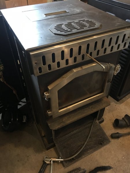

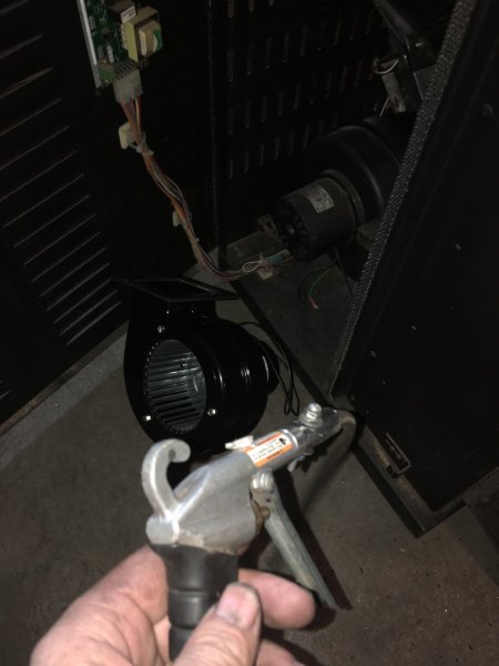

    I am installing a new Convection Blower into this Baby and blasting out the ash chambers with a compressor today.
    Good to have the auger bearing as a spare.

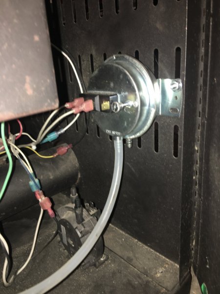

    After installing a new Convection blower, I found the high limit snap disc tripped. I removed the wires and checked the switch with my meter and found the switch was open. So using a screw driver. I reset the snap disc. You have to press a little harder on these snaps to reset them. So I put one wire back on and when I put the other back on, when I got close, I forgot I had the stove plugged in and I got zapped. So I unplugged the stove and connected the wire back. Then I plugged in the stove and when I pressed on there was no juice! Everything was fine but when we wired the new shop, we did per the new codes and put all new GFCI outlets in. Well the outlet that the stove was plugged into, the GFCI tripped and stopped the current flowing through me! My instinct is to let go of the electric wire and that also stops the current flowing through me too. Since this has happened to me many times before on non GFCI outlets and I let go, I am still alive. So does this really save lives? Probably for people who freeze and keep holding on, I do not know for sure. The GFCI outlets do really work and now I do believe in them. They do not stop current from going through you but they do kick in and limit how much current going through you!! Anyone else have this happen???
    Anyway, Stove is working fine and since the vacuum switch was marginal. I installed a heavy duty Cleveland Controls all metal vacuum switch like the old Whitfield’s use with 10-32 nuts and 1/2” long bolts, washers and lock washers. See pics!

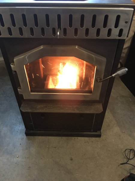

    Now the stove is done. Runs like a champ and has enough airflow to float the pellets. This week I will remove the venting and give it a good cleaning and I'm ready for winter.

    Although the pic is a bit fuzzy, do I see oiling ports on that convection blower??? If so, did they get 2-3 drops of 3 in 1 ?? (3 in 1 Blue can preferred)
  12. ChandlerR
    ChandlerR
    Mar 7, 2017
    470
    2,865
    Seacoast NH
    Oh yeah. I remove the blower(s) yearly and clean them and lube the bearings with synthetic oil. 10 years old and still purring. I think the exhaust blower's inner bearing was getting a bit worn though. It started making a bit of noise once or twice a day. Not a squeal but more like a rumble. I figured it was due to the heat. It was lubed just like the others. Now that I have a nice new blower with lube holes, I'll get at least another 10 years plus out of it.
