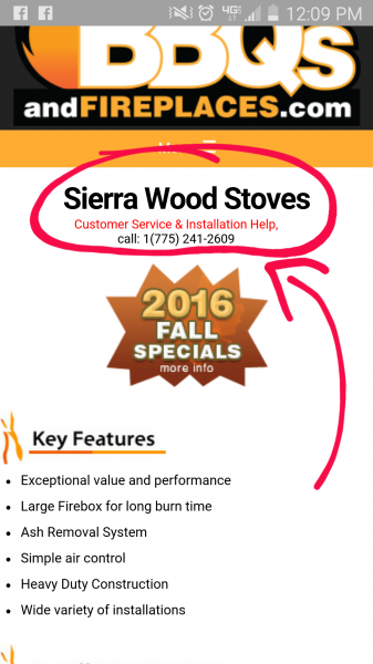

  6. Scotty Overkill
    9,272
    60,640
    Call this #, maybe they can help you out...
    papadave likes this.
