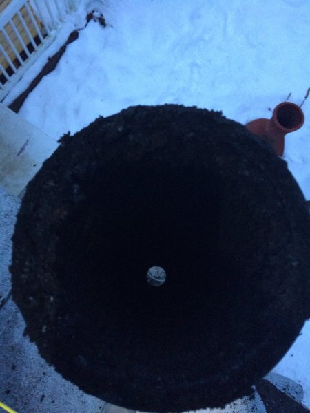

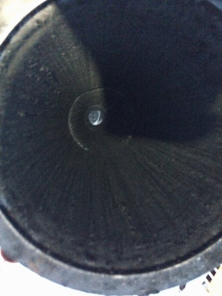

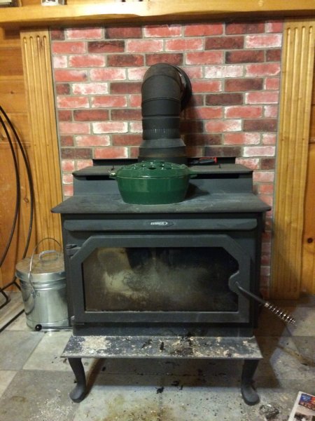

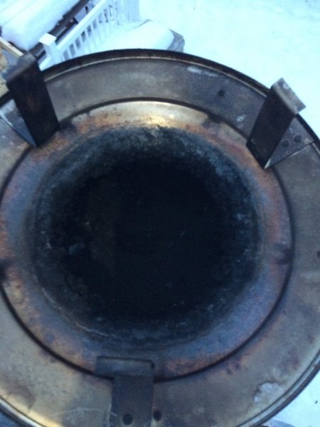

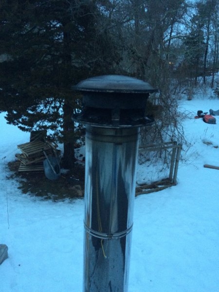

    Ok, I finally have pics to share with what I found when I went up on the roof.
    This is the before. A bit hard to tell that the cap is pretty well sooted up.
    This is the cap turned over. It didn't come out as I expected. The inside of the cap was pretty packed.
    This is looking down the pipe.
    Pipe after I cleaned it with my new brush.
    Finally a picture of my wood stove and hearth.

    Here are my findings from last night and today. While the exterior stove pipe had some creosote buildup, nothing that would have caused the loss of draft. The cap as I said in the last post was pretty gummed up. However; I don't think that was the problem. Both the cap and double wall SS have been cleaned, and are back in operation. When my son went out to put the ash bucket under the double wall SS, he found the bottom cap on the ground. I know I put it back on. Must not have secured it properly. Tons of crap is in the snow around the base.
    Up until today I did not have a flue temp gauge or a temp gauge on the wood stove. When I went to pickup the brush this afternoon, I also bought a magnetic wood stove temp gauge. When I lit the stove tonight, I put it on the single wall 6" pipe coming off the wood stove. This read just below the optimal burn numbers. After a while of it not moving, I put it down on the stove to get a feel for what temp the stove itself was operating at. The stove reads 450. Just about in the middle of the optimal range. As I don't know enough about the temps currently, I suspect my firebox temps tonight are good. I am not sure that the single wall pipe coming off the stove is accurate or whether that is a temp range I should expect.
    After talking with the guy at the fire place store in town, I truly believe that my problem last night was draft. So far I believe I've been lucky when burning these Envi 8 bricks as I often find them smoldering. My wife and I went over the settings and the placement of bricks. We've been putting the bricks in differently. Which does help explain it a bit. She puts them as she would splits. The land where they land. I explained to her that they need to be packed in tight together to form more mass and heat properly. The final piece is where she sets the air. At night she completely pushes in the air. Where I like to leave it two out notches. We are going to try it my way a couple of nights.
    Not to make excuses, but I think we were both a bit nervous of over firing these bricks. It's common to be told burn them carefully to avoid over firing. We've learned that you can under burn them to a potentially hazardous result as well. Now it's a matter of us working together to find a more optimal setting.

    If I had a cap like that I would be very concerned, that would scare the hell out of me, you are burning too low of flue temps.
