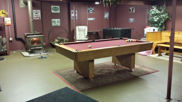

    I don't have my cold air return hooked up, so I am also heating my basement. But 90% of the time, I have a wood stove cranking down there. All together, I am heating around 3,000 Sq ft. I love my Fahrenheit. Going on year 4 with my Fahrenheit and I love it. I also have the OAK hooked up and would recommend that as well. It will help eliminate any extra cold air infiltrating your home.
    Again, I am burning wood, but also heating over 800 Sq ft that I really don't have to.. If I had the cold air return hooked up.

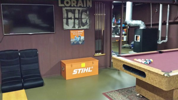

    Welcome to the friendliest wood/pellet heating site on the Internet. There are a few of us Fahrenheit owners here, as well as a group of very knowledgeable pellet burners.
    I hooked mine up as an add on to my oil furnace. I don't have my manual handy, but I believe there are illustrations that show where the backdraft dampers would go. Those will keep the heat from 'looping' through the hot supply and cold return ducts. I have one damper in the oil furnace above my AC a-coil and a butterfly damper in the outlet of the Fahrenheit. The damper in my oil furnace is a home brew unit, but it does the trick. I set the thermostat on the oil furnace to 52 degrees, so if the furnace goes out or something else goes awry, then the oil furnace will kick on. Lucky for me, that hasn't happened yet.
    If you could hook it up standalone as Dexter mentioned, that would make the most out of what the convection blower has to offer. For me, that would have been a huge pain in the rear. If you do use the existing ductwork, the best I can offer is to seal the ducts as best as possible. I also insulated my supply ducts, which wasn't very expensive, but just time consuming.
    My unit is an older first generation unit (manual ignition, LED control board). The units that Dexter and Ivanhoe have are newer automatic ignition units. I have a bunch of pictures I took from a cleaning and replacement of one of my burn pot components, but I haven't made a thread on it yet. One of these days I'll do that.
    Feel free to ask questions. We're here to help.
    Edit - I'm heating just under 1700 square feet on the main floor, and half that in the basement. The other half of the basement is the utility room and doesn't have any registers, but stays pretty warm from the furnace being over there. I'll post some pics of my install in the morning when I'm back at my computer.

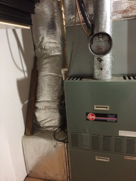

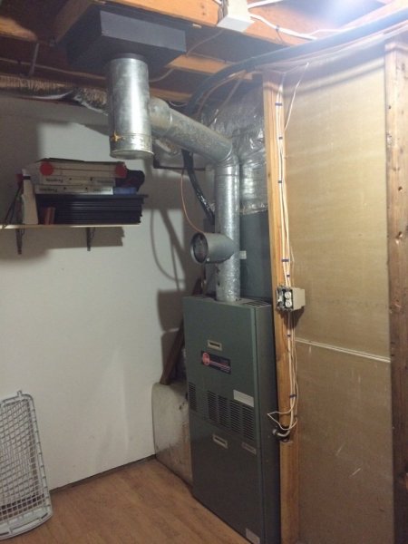

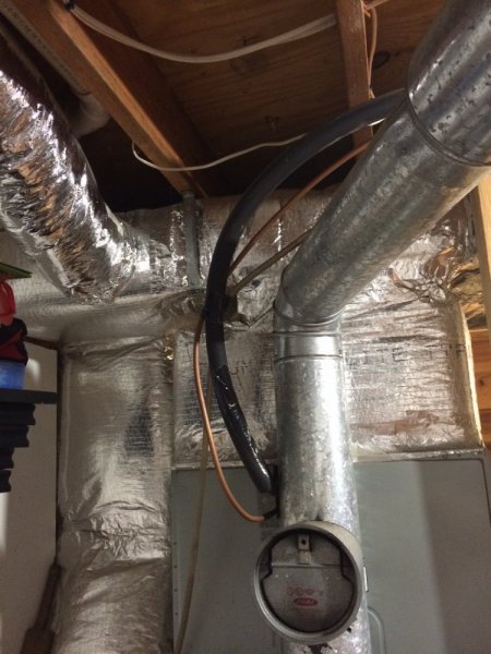

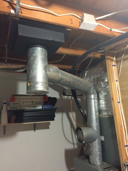

    Here are a few pics from Triple A Arsenal.
    This is the current furnace set up.
    eatonpcat and smoke show like this.

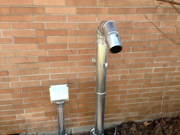

    Here are a few pics of my install. I had to extend the cold air return a few feet, but outside of that it was just a matter of finding the 10" round duct and start collars, then the time to get it all hooked up. These were taken right after the install and before I insulated the ductwork.
    One thing that isn't optimal with mine is the location. It is at the far end of my basement right underneath the master bedroom. My oil furnace sits right in the middle of the basement. I didn't have any way to properly vent it from that area (would have been a heck of a long horizontal run, which isn't a good thing), and the pellet furnace would have been too close to the oil tank. Most of the take offs to the room registers had dampers in them, so I close down the ones closest to the furnace and open up the ones farthest away. Not the greatest, but it works.
    My 'backdraft damper' is manual as well. Well, sort of manual. It slides into the plenum on the oil furnace and rests on three L shaped "shelves" that I attached to the plenum. At the start of the season, I slide it into the plenum. If the blower on the oil furnace ever turns on, that damper (which is just a piece of sheet metal) will rise up and let the air flow through the plenum. When the oil furnace blower shuts off, it drops back down into place. Its a bit of redneck engineering, but I couldn't find any way to put a "real" backdraft damper in the plenum without redoing the entire plenum. If I need to run the oil furnace exclusively, I can slide that damper out and its back to normal.

    Your install looks good. I was trying to avoid drilling through concrete in the basement to get outside by using the existing flue since I don't plan on running the oil furnace. But I see now it's a BIG no no. So I will reconsider the endurance placement again and start from scratch. How did you drill through what looks like block?
